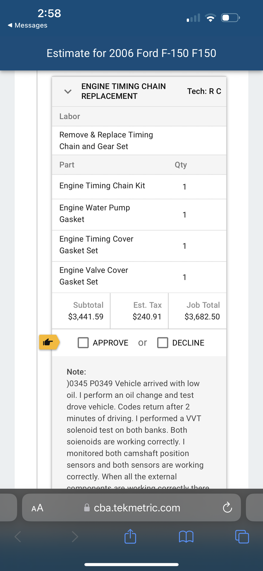

Does this quote look right ? 2006 5.4 f-150 Timing chain replacement
Old Mar 8, 2024 | 02:10 PM
Mucky's Avatar
Joined: Mar 2024
Default Does this quote look right ? 2006 5.4 f-150 Timing chain replacement
Engine was ticking and had codes p0345 and p0349. Brought it to an auto shop and they said my timing system needs to be replaced. Does $3400 seem unreasonable?
Old Mar 8, 2024 | 03:56 PM
A good shop will not usually complain if you obtain other estimates for the job. Just make sure they are doing the same thing and providing the same parts
Short cuts can sometimes cost less , but only in the beginning. Sometimes, we wind up paying more in the long run.
