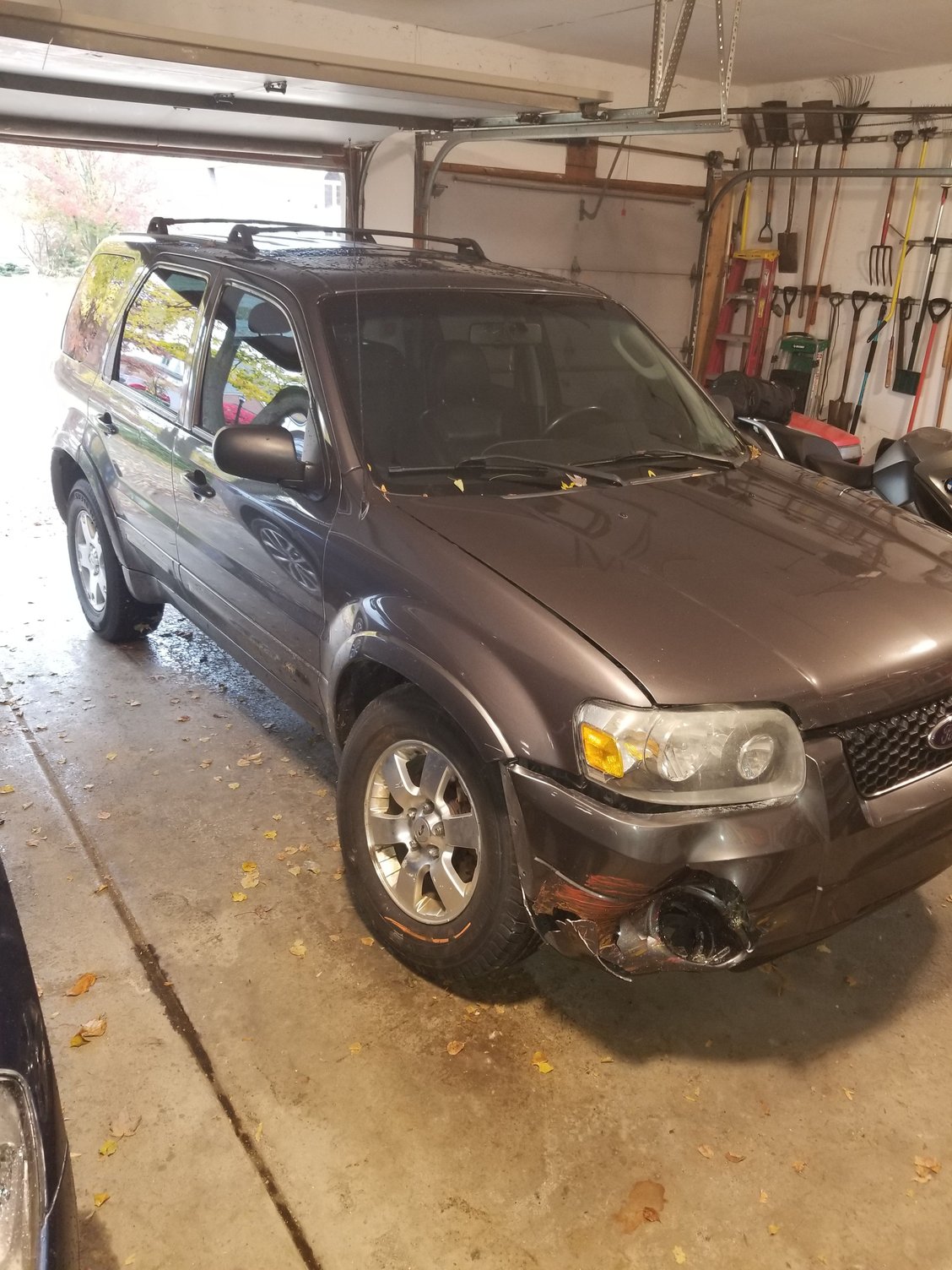

I didn't think it was a huge deal, I limped it home and went to the scrap yard and got a new wheel/tire combo (looked for a fascia but none matched... I'll have to keep my eye out).
But when I put the new wheel/tire on, the top is wayyyyy tilted in and the bottom is wayyy tilted out, like it's "chambered".
I'm pretty good with cars, worked on them a ton in the past, but I'm not very good at troubleshooting.
What can I check/replace to fix this problem?
Any suggestions would be hugely helpful,
Thanks!
This is when I took the wheel off.
This is the new wheel on (I know it's a different style but I'll deal with that later.
BTW it's an '06 Escape Limited AWD and I really like it for what it was, great little SUV. I'm mad that I hurt it 😕
Last edited by KennyCanoe; Oct 26, 2022 at 12:14 PM. Reason: Sorry, "chambered" not "chambered".

"chambered" is supposed to say "cambered", is in wheel camber. Stupid autocorrect.

At the very least you need a front end alignment. Worst case is you bent something (maybe a strut) which will prevent the alignment to be set to specs and require replacement. Time to take it to a shop for a front end inspection.You won't be able to set the alignment yourself.
I wouldn't be surprised if the wheel bearing assembly was damaged too.
