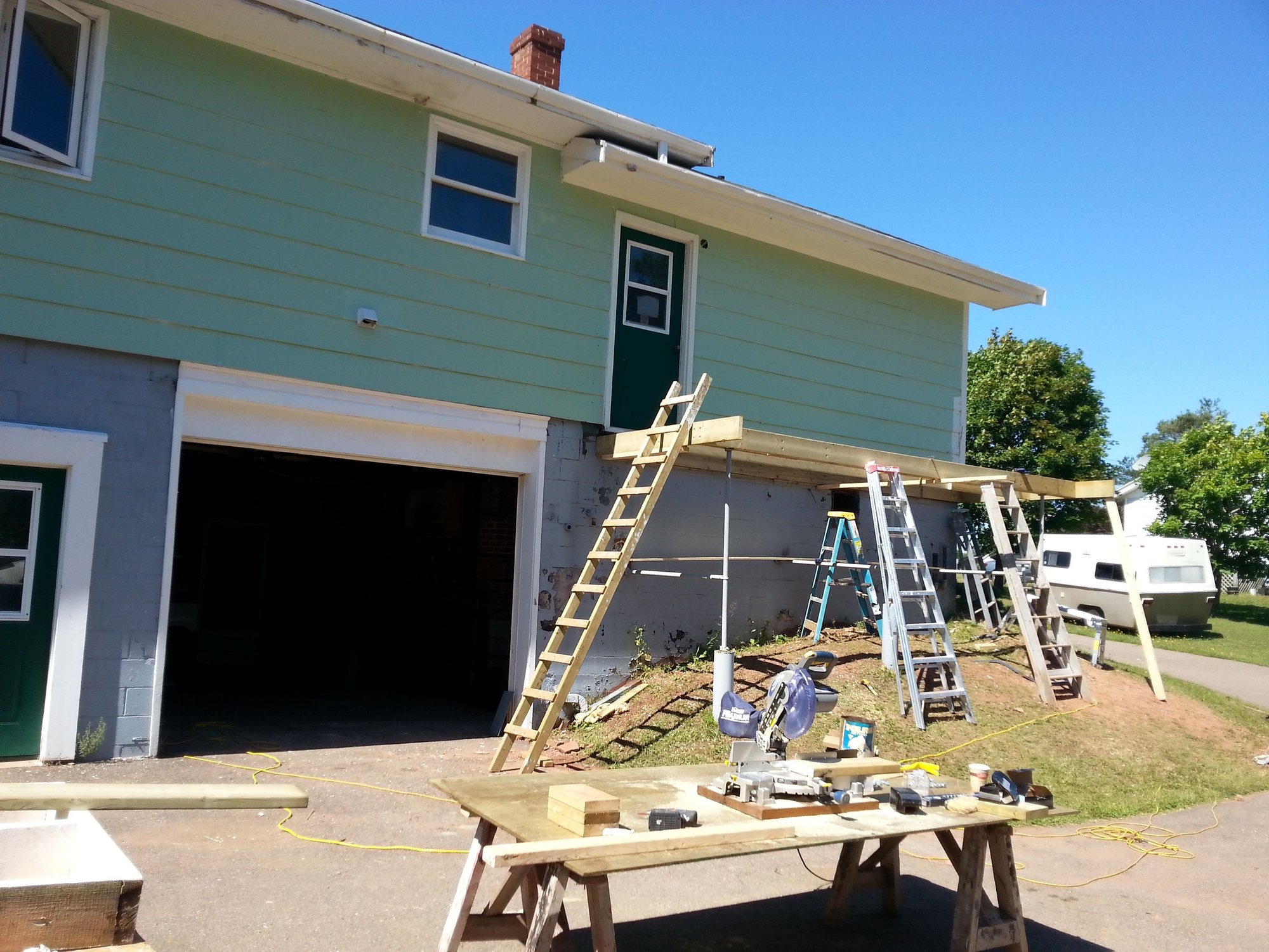

this is my property 10 ft high basement.
