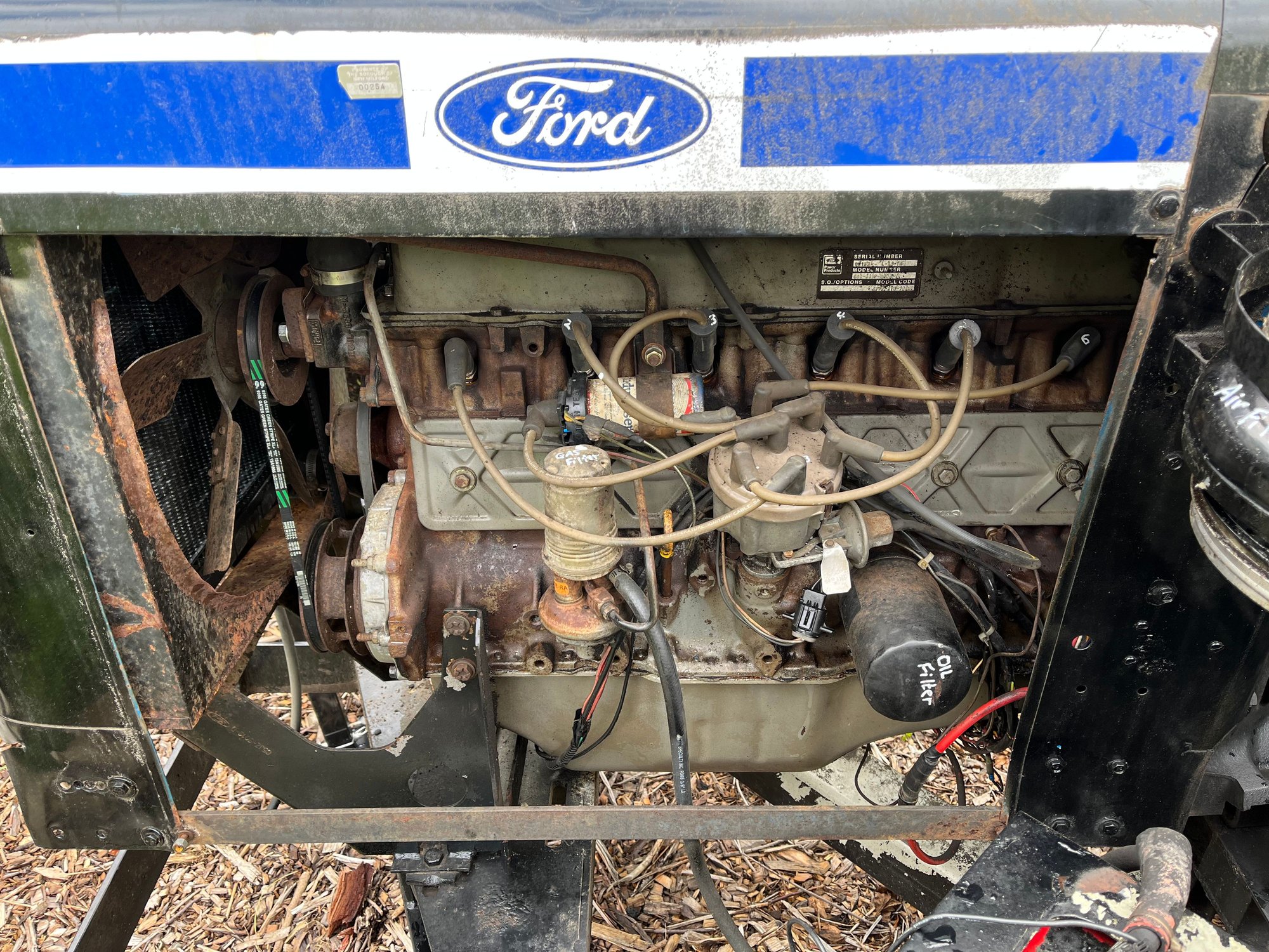

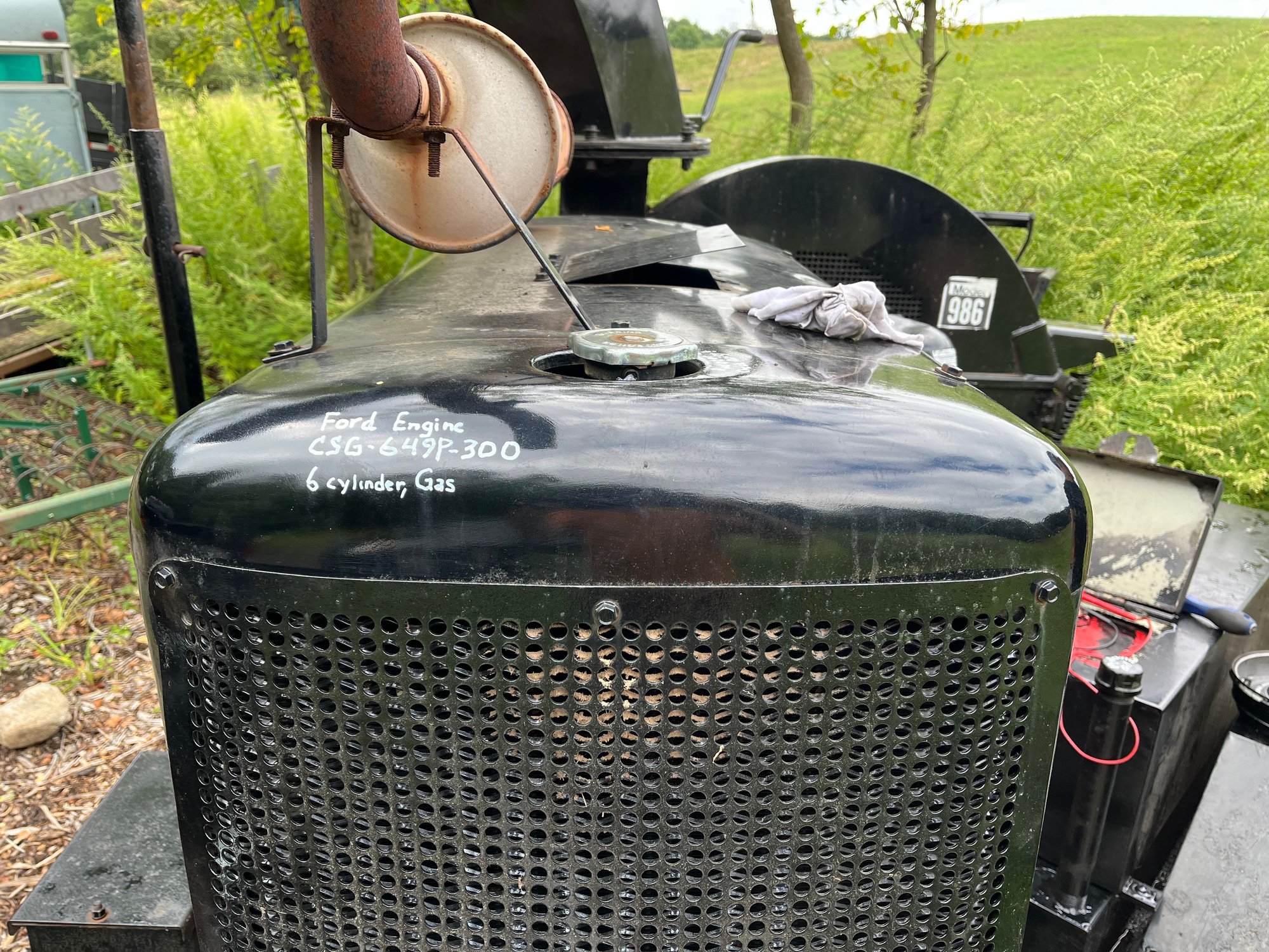

I am stumped. This 1980’s era, Ford engine “csg-946 300” is on a wood chipper and was running along just fine but suddenly stopped and I can’t get it to start.
Ignition:
The engine has electronic ignition and a neon spark tester on the coils’s high tension wire shows lots of healthy spark, as does the same tester on each plug wire.
Timing:
I didn’t check if the distributor was loose or rotated. I do need to double check this although I’d expect the engine to at least run rough with bad timing.
Compression:
seems good enough to start
120
100
125
120
125
125
Fuel:
Tank is 1/2 full of fresh fuel. It looks clear and without water contamination.
Fed some gasoline directly into a vacuum hose port below carburetor. But no pop or stutter results. This isn’t so satisfactory as we didn’t get much fuel in this hole. Tomorrow I’ll take some starting fluid and spray into the air intake.
This is rather frustrating. Does anyone see what I’m missing? I’ve got spark, compression and at least some fuel, I should at least get a few pops.
Thanks !

Today we :
1. checked all sparking is good, pass.
2. sprayed starter fluid into the air intake. No firing, no popping
3. Squirted raw gas into intake manifold below carburetor. No start , no pop.
It could only be timing, right??
Do these engines have timing belts or chains or gears?
it almost seems as though either the valve timing is off or the ignition timing is off.
Next step, check timing with timing light.
Chipper w ford csg-649p-400 engine

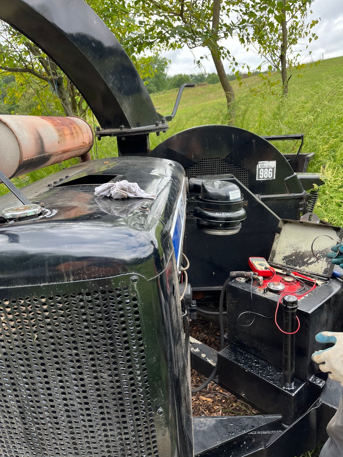

Problem solved
we took it to a mechanic who correctly diagnosed that the choke was stuck full on, so we elected to fix it ourselves.
Took off the engine shroud and got full access to carb. Choke was stuck closed, so got it freed up but then it would start and immediately die. That turned out to be caused by a weak battery that wouldn’t keep the Murphy switch open so after starting, it immediately died. We then charged the battery for a few hours and it started and stayed running.
Have given the carb a good cleaning so the choke & throttle butterfly’s don’t get hung up.
We learned our lesson: check everything including the carb even if it’s a pita to access. I assumed any engine would fire with starter fluid spraying in intake, well not if choke is fully closed.
