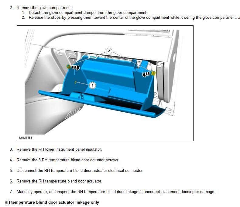

I followed the instructions shown below from the shop manual.
Except I don't know what step 3 refers to. Anyhow, is step 3 the secret to getting to the barely visible and hidden screws? Seems doubtful.

From the shop manual.

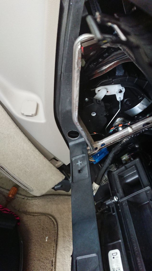

I am trying what you say. Still trying to figure out what they mean by "RH lower instrument panel insulator".
I paid $177 for the CD version of the 2014 MKX shop manual and I can't find that item. They nicely annotate obvious things like "glove compartment release stops" but not the "RH Lower.....".
I have searched the entire manual and never find the word "insulator". The CD doesn't have a search function so it is manual clicking link after link.
I have found an exploded view of that area and it dose not show that black cowling where I drew the circle with the "?" in it. They show similar things including where the attachment points are but not the cowling that is blocking me.
As you can see in the picture I have removed the screws holding that cowling (two of three screws are shown). I have pulled hard on the area near the center screw and had some success popping that horizontal section loose but that is all. With a mirror I can see many attachment points along the left and right sides of that cowling but I can't pull hard enough to get any to pop.
Those attachment points seem to be made up of a tab (maybe 3/8 inches wide) with a white clip over the tab. It is possible that the white clip should come off to release the tab. Could that be or do I need to force the tab and clip out together?
In the mean time I will try more force and search for hints on how to remove a "RH lower instrument panel insulator".
Thanks
Pete

I cant find that trim panel in the workshop manual exploded views, I can tell you the white clips on the tabs should stay attached to the panel you remove. If I cannot figure out how to remove a panel I just start taking the panels around it till I can figure it out. Without looking at it I wont know what to remove but I am thinking if the center console is removed that trim panel would be easier to access.

(1) Good to know about the white clips.
(2) I am taking your advice about removing adjacent panels. But every one seems to be interlocked with another panel. The right center console panel is partially loose. Good thing I noticed that an air duct got disconnected when it moved. That is my concern, disconnecting something without noticing.
I also managed to mangle both "X- shaped studs" next to the screws I removed. You can see one of them next to the screw I removed. No big deal.
I am considering drilling a hole where the circle with the "?" is so I can get to that screw but there is a steal bracket behind it. I think I would end up having to drill through that
If I realy get desperate I may cut that cowling where it makes the bend then swing it out of the way enough to get to the screw. Then patch it with an angle bracket. Just idle thoughts while my 74 year bones try to recover from crawling under the dash. ;-)

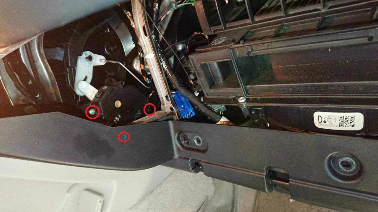

Well, I found a solution. I removed that cowling that surrounded the glove box opening and found another one underneath. Just to get the outer cowling (the one in my first pic with the "?" over it) I had to remove a side panel then a panel above the glove box opening. There I found three more screws holding the cowling. After that I managed to muscle out that cowling only to find the one behind it.
At that point I decided to go commando. I used a hole saw to drill through the cowling. See the picture below.
If I had to do it over, I would save myself a great, Great, GREAT deal of trouble and just use the hole saw through both cowlings. And if anybody finds this thread before they go to far, I recommend they do that also.
Thanks Hanky and Scott!
