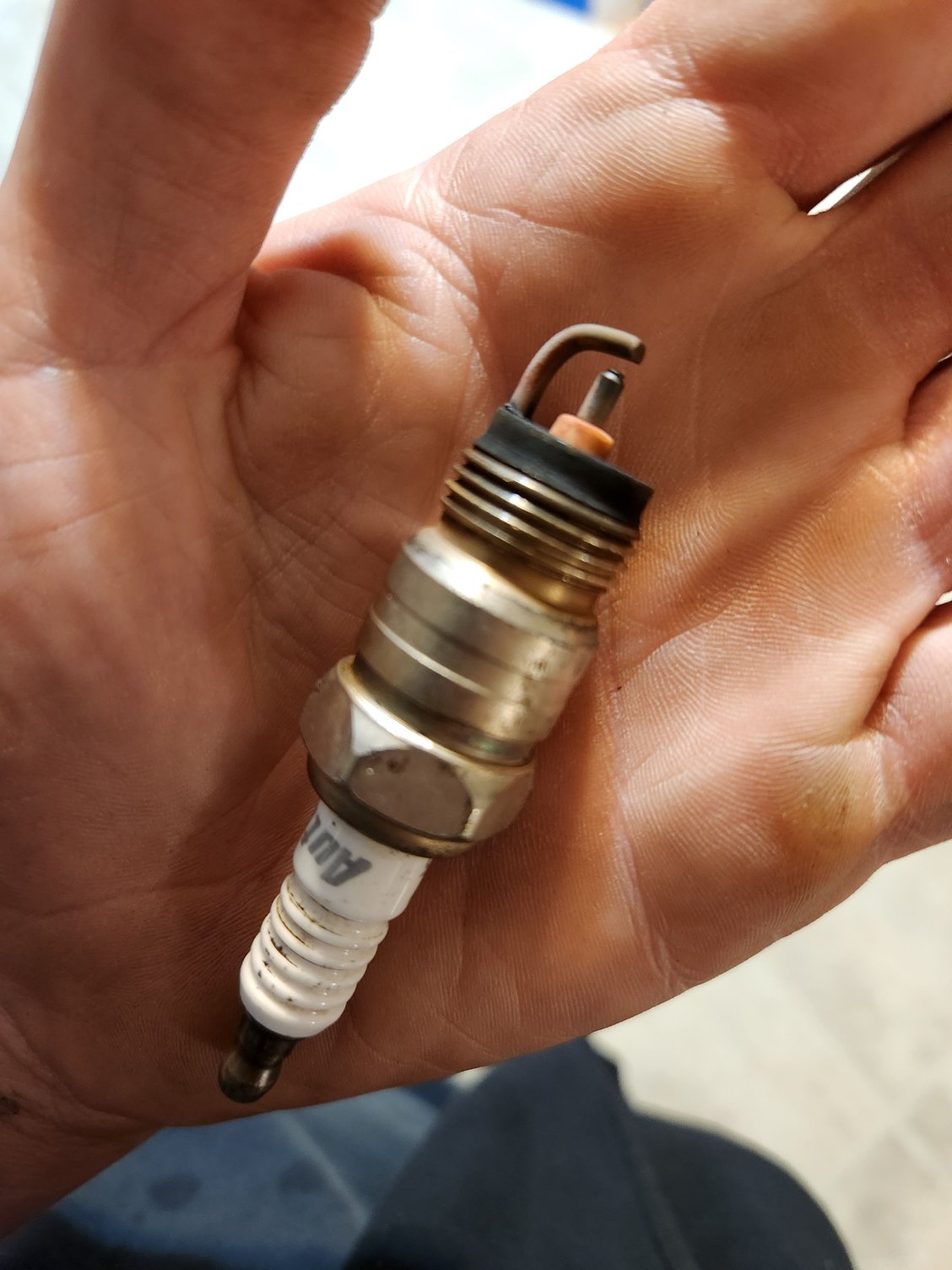

Old Aug 17, 2023 | 09:47 PM
richardjk1999@gmail.com's Avatar
Joined: Aug 2023
Posts: 10
I removed the middle spark plug and here is what it looks like
Middle plug
Old Aug 18, 2023 | 07:41 AM
From the pix, can't tell if plug is wet or dry ,plus how long has it been out, did it dry off?
