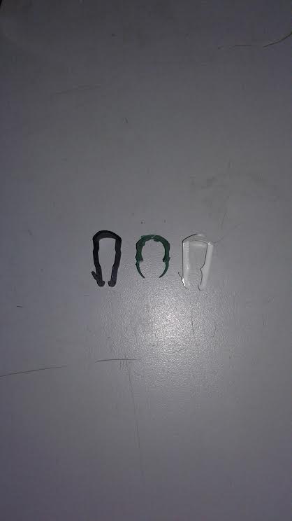

Has anyone else run into my situation, and did you have to go to Ford for the correct clips?? The filter I got is correct, but not the clips. The green one in the center is the correct ones, the otter ones are the ones provided with the filter. The second pic is the clip housing. The clip does is not visible on the top of the housing as most are?? I live in Canada, not sure if parts are different. Thanks in advance.

As far as I know, the Freestar uses the spring lock connectors on each side of the fuel filter, no clips required. With spring locks, the fuel line should just slide back onto the new filter ends and lock into place. How did you remove the fuel line in the picture?

Oops, wish I had know that. I had looked online and all it talked about was removing the clips, which I did..... Looks like I will know have to take it in. I found some FMSI repair lines (see pic), but you need a special too install. Thanks
