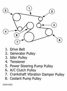

Hi buddies! What the cost to replace the timing belt in my 2005 Ford freestar?

The Essex V-6 engine in your Freestar does not have a TIMING BELT. The engine uses a TIMING CHAIN. However, if you're referring to the accessory drive SERPENTINE belt, then they cost around $20-30 for a premium Gates, Dayco or Goodyear belt.
