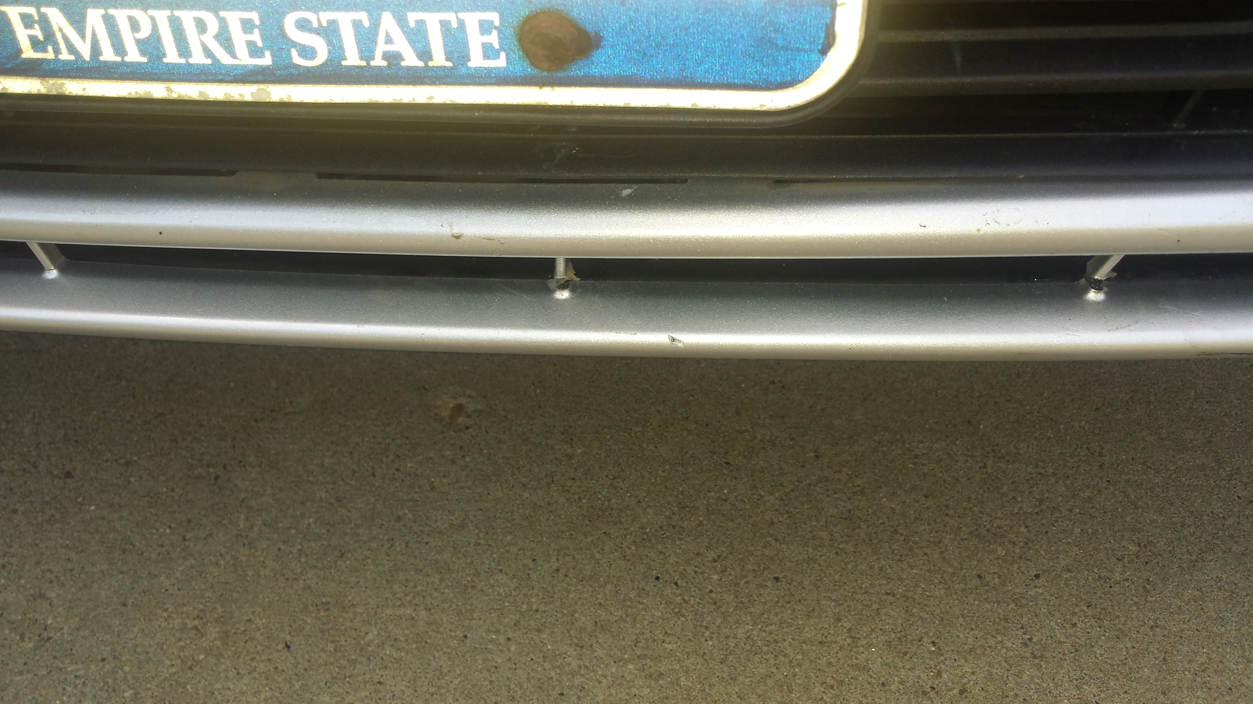

i have a 2013 fusion in which 2 of the little vertical pieces broke off from the bottom where they were attached pls see pic. i tried 2 part glue with no luck, do you know of a glue such as jb weld that hold this together otherwise i may be replacing the entire grill/bumper assembly thanks paul

Try drillng a couple of small holes on an angle in each side of the break. Then mix up a little JBWeld and get it into the holes, then on the break itself. The join the two together, that should hole. I have done it to a few breaks like that. Works great until you bump into something again.

thank you common sense i will try that in the next week or two and report back. its funny how an almost undetectable defect in a car like that can change it from your pride and joy to a piece of junk..i want to nip it in the bud before another similar thing happens and i give up on it
