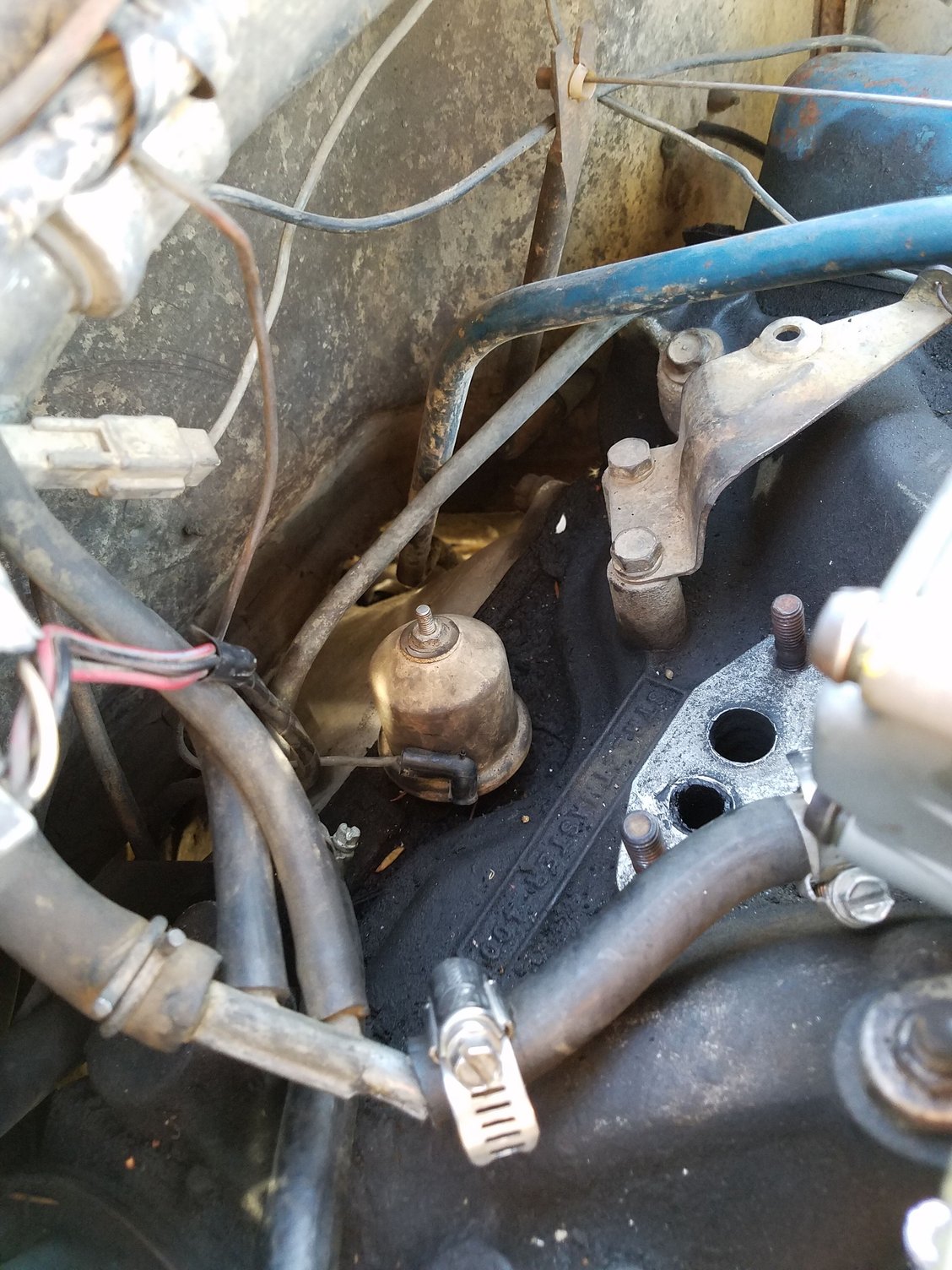

Good evening fellow Ford friends. I have a 79 f150 4x4 ranger with a 400m motor and love my truck. Coming home from camping trip this weekend she died twice on the freeway. I had here towed home. When I looked under hood I saw some smoke coming from back of motor. I thought maybe bad egr valve. Today after removing egr valve I notice this part -picture attached, does anyone know what it is?

Old Jun 13, 2018 | 08:56 AM
The single wire bell looking part?
Is the oil pressure sender....

Yes, is that the oil sender unit? If so, I do not believe it is my problem. The reason I have focused on that area was because when truck died I saw some smoke come from that area. I have cleaned egr valve - it wasn't that dirty so I am back on hunt for why truck dies under load - accelerating....

Yes it’s the oil sending unit..
