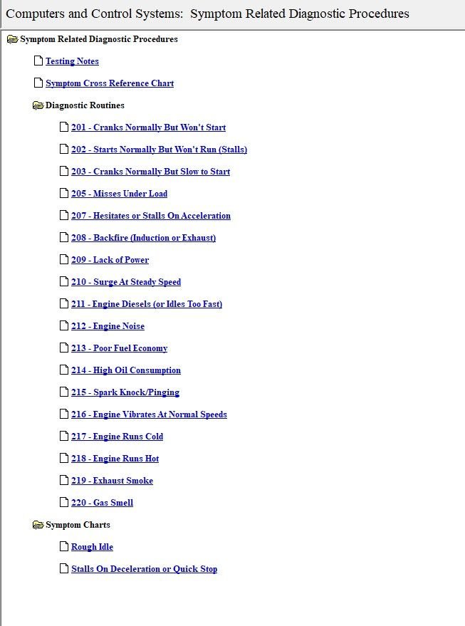

Diagnostic Routines index page shown above. Download Diagnostic-Routines.pdf below.

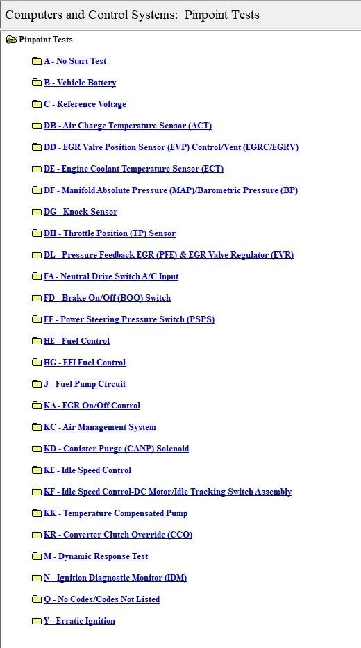

Pinpoint Tests index page shown below.

Old Oct 14, 2025 | 01:09 PM
Michelene /Driver,
Were you able to select the condition closest to the problem with your vehicle and were you able to correct it ?
