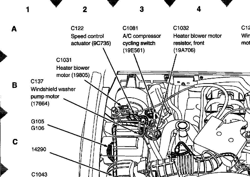

This pic shows the location of C122.

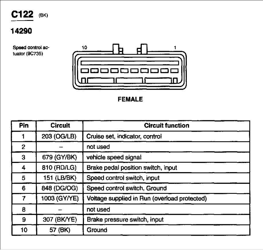

And here's the diagram of C122:
You just need to remove the electrical connector. You probably don't need the C122 removal procedure diagrams, but please ask if you do. You can perform most of the tests right at C122. Please do NOT blindly buy the cable, it's $100+. Download 4.pdf and 5.pdf below should get you started.

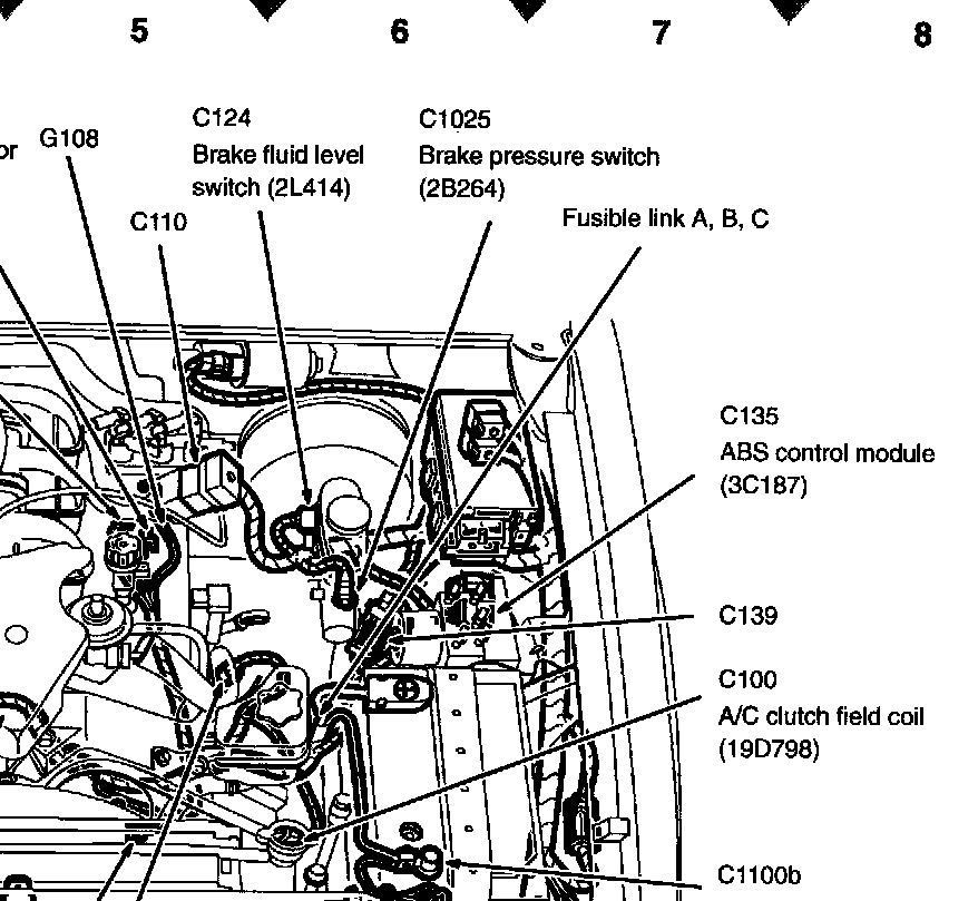

Here to locate C1025 (brake pressure switch):

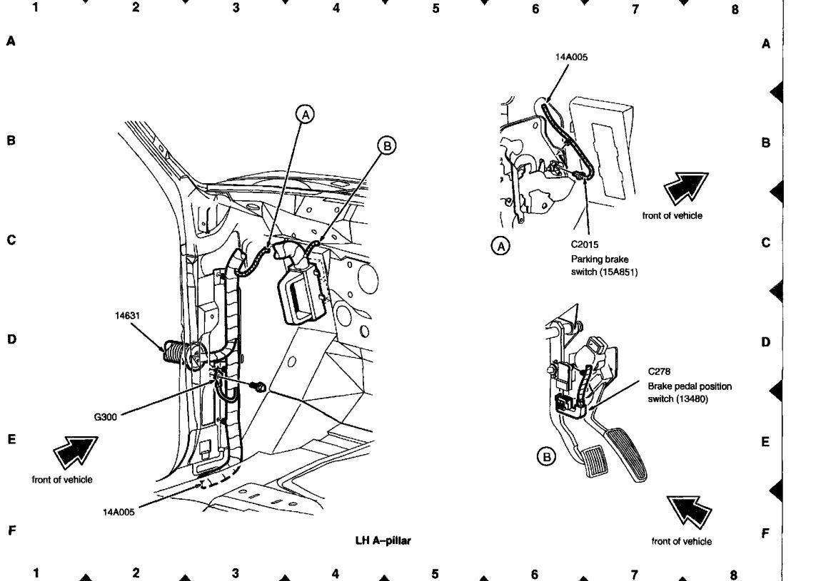

Here to locate C278 (Brake pedal position switch)
C278 is adjustable, so don't blindly buy a new one. You should know your brake switch(es) are for CC disengagement, and you are having problem with CC engagement but a "sticky" C278 can make your C122 to think that your brake is currently depressed, not allowing CC engagement as a result. There is also other check you can do quickly like checking your brake lamp does it respond immediately when your brake pedal is depress/release.
