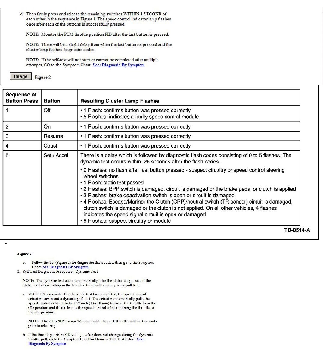

If you really intend to fix this yourself you should invest in the diagnostic tool, get a digital multimeter (it doesn't need to be Fluke brand, even the less than $10 at harbor freight can do a lot of things). You can check FORScan ELM327 adapter on amazon or ebay (you need a laptop though). Some test lead back probe kit is also helpful.

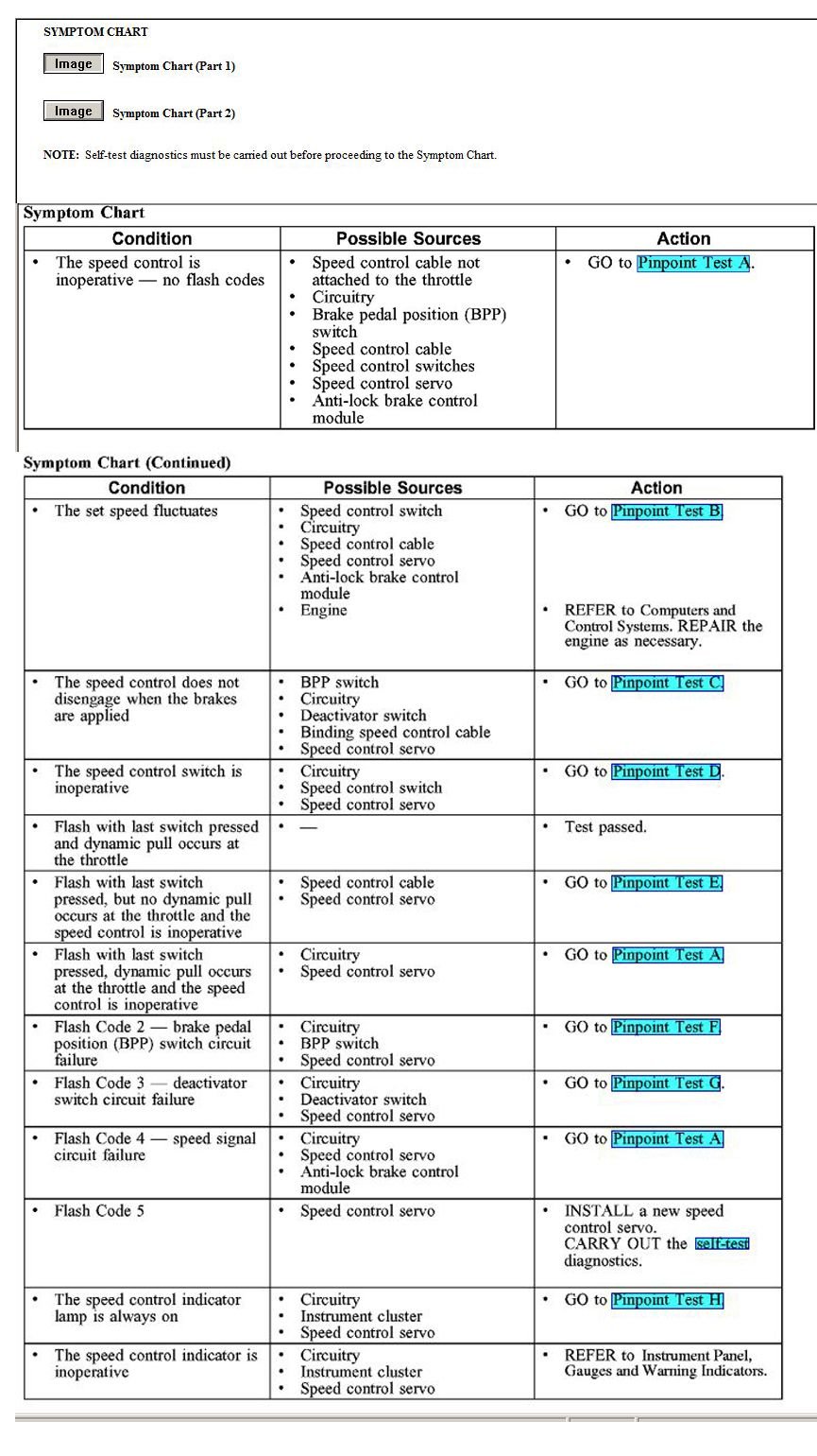

Here's the "Diagnosis by Symptom" (even though your symptom is not found):
Which Pinpoint Test A to H you need let me know so I can attach that here.
Again, based on your symptom I suggest you to check for vacuum leaks first, especially if your HOT idle speed is NOT between 800-1000 RPM (per ford's spec) but higher.
There are tests that can be done easily in seconds with a digital multimeter, you should test those out first just to narrow down the possibilities.
