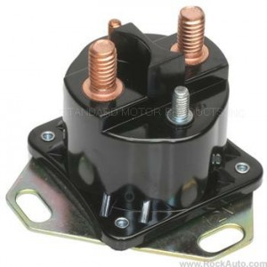

Thank so much for answering. It's the one in the left rear of engine I can not locate. Does it look like a solenoid or is it a little switch?

A starter relay will look like this animal. It's about 2" in diameter and 2" tall.

start either at the battery + or starter motor. follow the large battery+ cable as it routes from the battery to the relay to the starter.

After finally going to a Ford dealer asking for parts, I figured it out. It appears the only starter "solenoid" on this version of Sport Trac is on the starter, which you have to put car on jacks to get to, as it's right next to the oil pan. The "relay" switch (is what I'm calling it) is a fuse type thing in the power junction box. However every auto parts store I went to tried to sell me the fender mounted solenoid, which does not exist for this version of Sport Trac.
