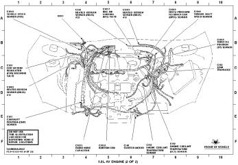

the fuel pressure is 39 lbs. where is the cam position sensor on this taurus? i can not seem to locate it anywhere. 3.0 dohc 24 valve duratec
Old Dec 14, 2010 | 03:03 PM
way2old's Avatar
Joined: Jan 2006
Posts: 1,234
From:
Left rear of engine front cover, below valve cover
There is a location chart below. Not very good, but the best I got. Might need a magnifying glass to see it.
