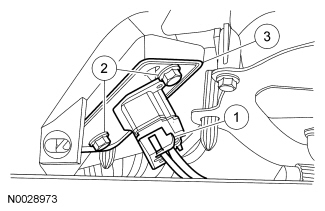

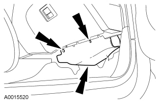

Removal and Installation
Remove the RH lower instrument panel insulator.
(thumbnail1)
Remove the blower motor resistor.
Disconnect the electrical connector.
Remove the 2 screws.
(thumbnail2)
To install, reverse the removal procedure.
