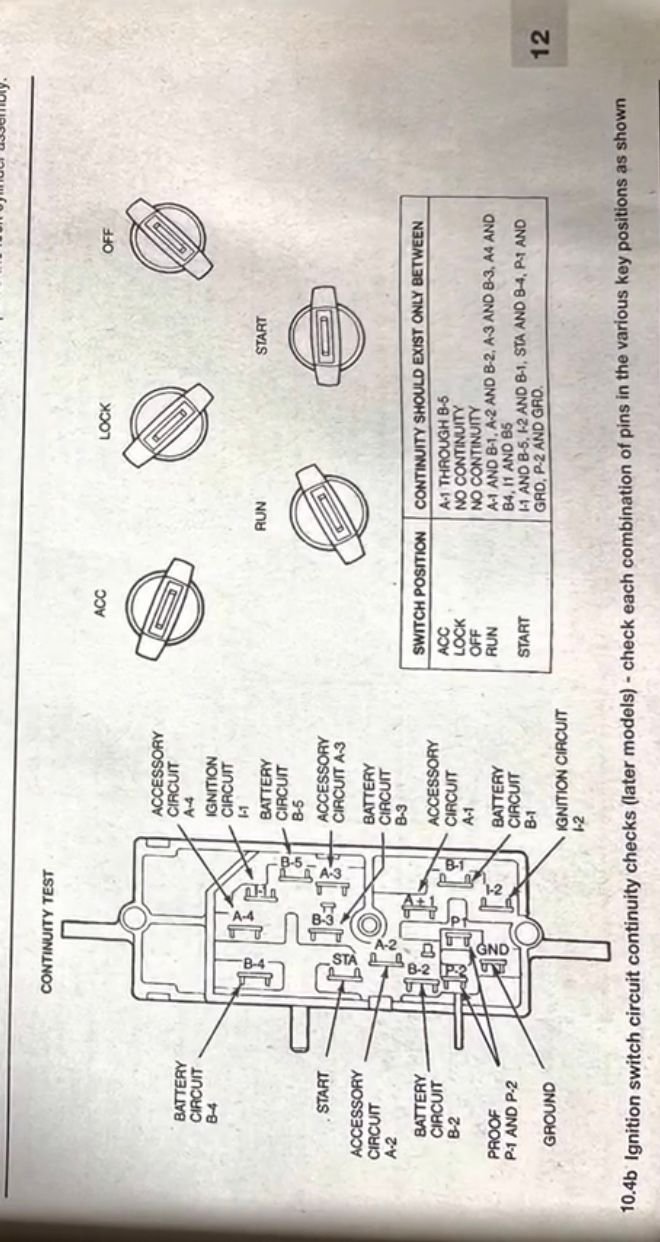

I removed the ignition switch and tested continuity per the attached diagram. No continuity problems found.
The quest continues.
Somehow the dash is getting power when key is in the off position. In my very inexperienced opinion, I thought the switch would be the problem. But that doesn’t seem to be the case.
