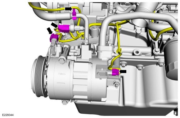

I could use some help please. I have a 2018 Ford Escape Titanium with the 2.0 L engine and turbo. I have a 4 pin plug that is on the same wire harness as the AC compressor that I do not know where it plus in to. It is short. about 6-7 inches in length and I would think would run to the radiator or intercooler but both are new and neither have a connector on it. Any ideas? I bought this to fix up after an accident. Thanks in advance.

Here's an image of the 2.0 compressor and local connectors if you can reference length/position etc. Or, if you can post an image of the connector face, I may be able to look it up..
