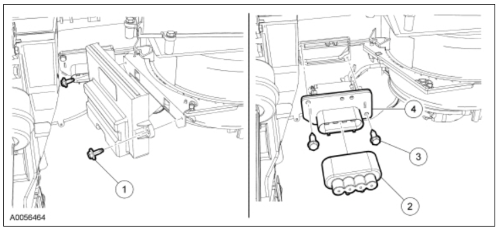

2 - Sounds like the AC blower resister is bad, I can give you wiring diagrams so you can do diag before replacing anything but considering the part is less then $20 aftermarket I would just replace it if it was my vehicle. Here is the blower motor resister location marked as item 4, the first picture is the 4x4 module that must be removed to access the resister.

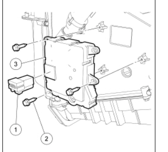

3 - Do you hear a faint clicking noise in the dash when you try to change temp? If so replace the blend door actuator. If you do not hear clicking, physically check the blend door actuator, remove the trim panel in the directions below and put a hand on the actuator, change the AC temp from one extreme to the other extreme, you are feeling for movement in the actuator to see if it is getting the signal to change temp. Let us know what you find.
Removal and Installation
  1. Remove the LH floor console finish panel.
  1. Position the in-vehicle temperature sensor aspirator hose away from the LH temperature blend door actuator.
  1. Remove the 3 LH temperature blend door actuator screws.
  1. Disconnect the LH temperature blend door actuator electrical connector.
  1. Remove the LH temperature blend door actuator.
  1. To install, reverse the removal procedure.
