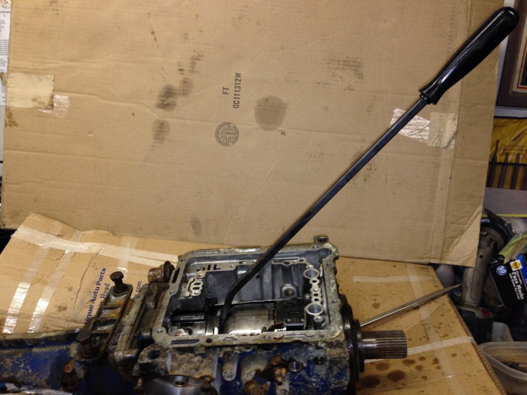

I'm trying to take apart a 1972 C4 to rebuild it.
I read where they say to remove the front pump you use a pry bar between the reverse drum and forward drum assy as pictured below.
I tried it. The pump won't budge.
I'm afraid I'm going to bend or destroy the reverse drum tabs.
There aren't any threaded holes in the pump to put bolt in for a puller.
How do I get the pump assembly off?
This one is stuck in there...
Danford1

I can't pull up your pix , but you may need to remove the pan and see if there is anything connected to the front pump assy that might be hindering removal.

I already have the valve body out.
The picture was showing the inside of the trans where the pry bar was.
I got it out.
It took a while but I got it.
I had to tap two of the holes in the pump with a 7/16-14 tap. I then welded up an adapter for my slide hammer puller. I screwed the adapter into the front pump and it took A LOT of slams to get it free.
The gasket was fused to both the pump and the case and had it glued together.
The gasket had to be split or torn for the pump to come out.
Some spray on gasket remover ate the gasket off both pieces so I
didn't have to scrape anything...
Thanks.
Danford1
