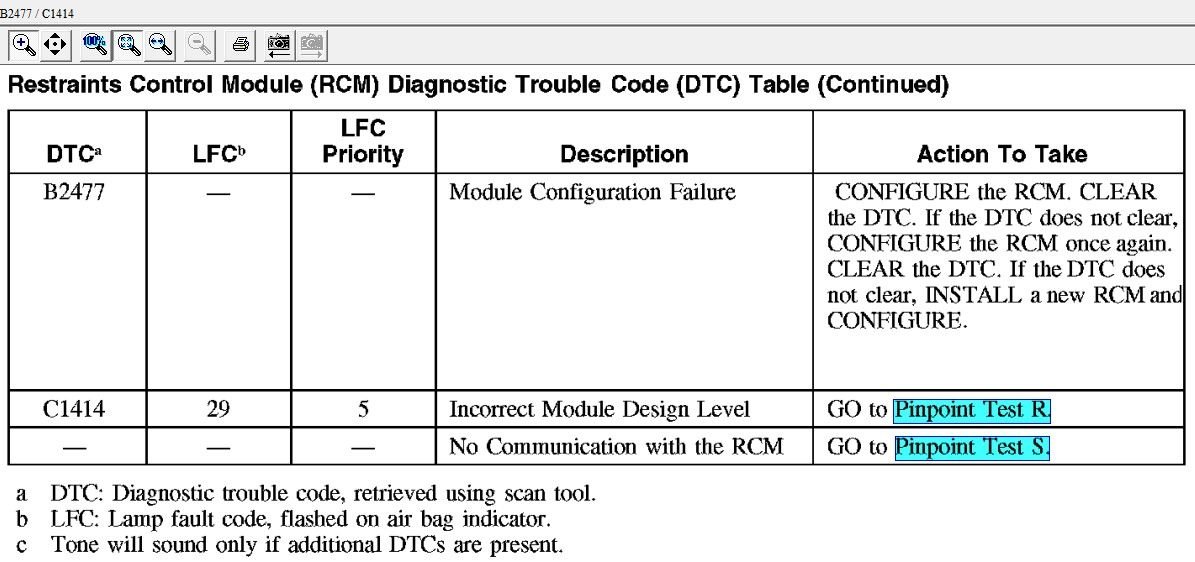

Check my signature below. I had to search the threads started by you to find out you have the above vehicle.
And I assume you have DTC C1414.
