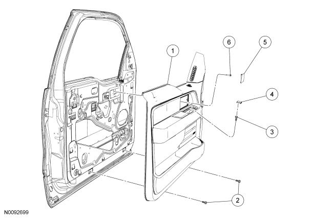

need to replace passenger side mirror on 2010 f150.How do i get door panel off?PLEASE HELP

Here is drivers door. #2 #3 and #6 are screws. There is a little cover over #3 screw. Passenger door is the same. When you get it removed, there are 3 holes that have the nuts in them that hold the mirror on. Unplug the wiring, if any, and remove mirror.
