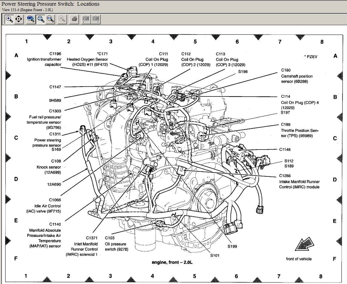

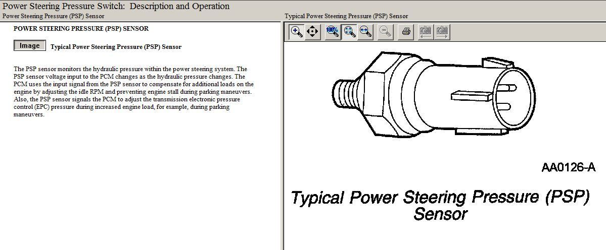

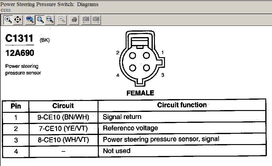

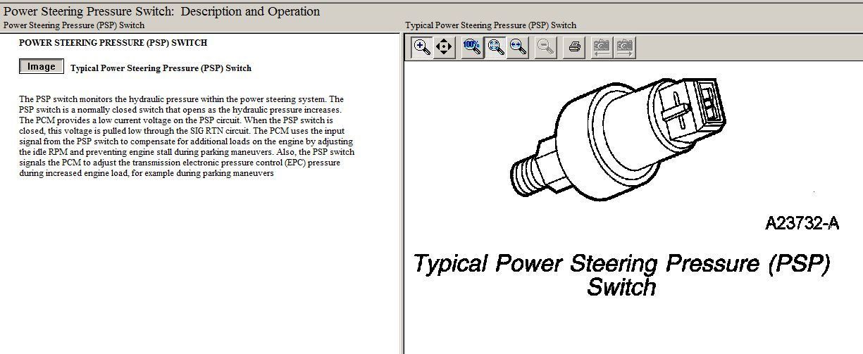

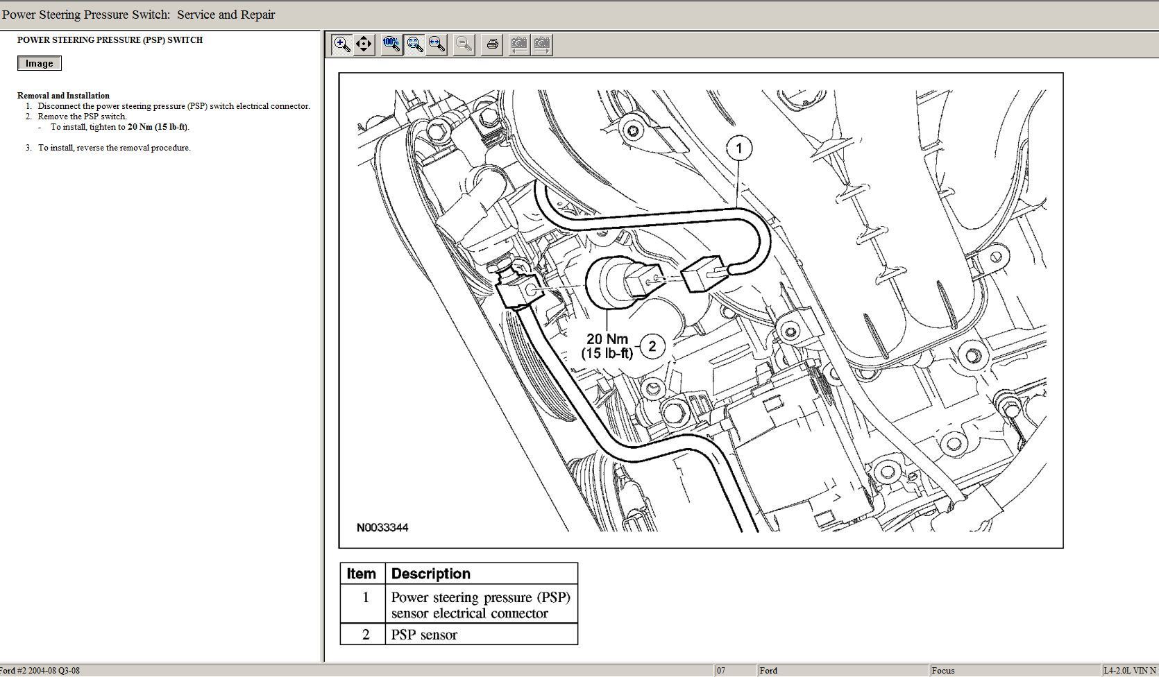

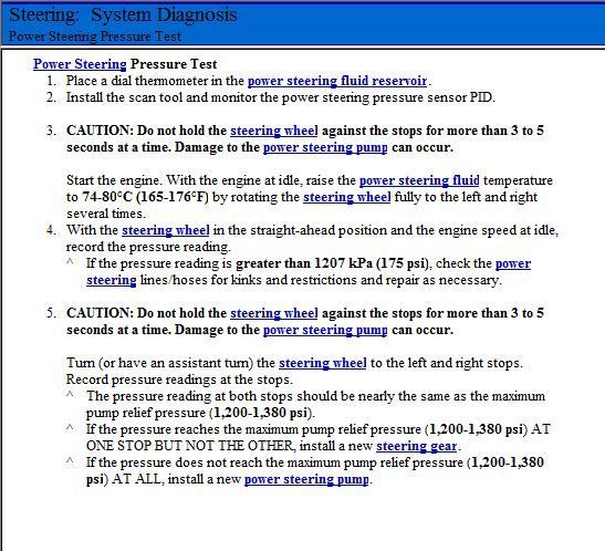

I don't have any diagram for 2011, my alldata software only up to 08, but my 08 doesn't show any helpful info on your car, so below is from 2007, same generation as 2011 for your reference. When your fluid turned grey that's already a sign that some broken metal component internally.
