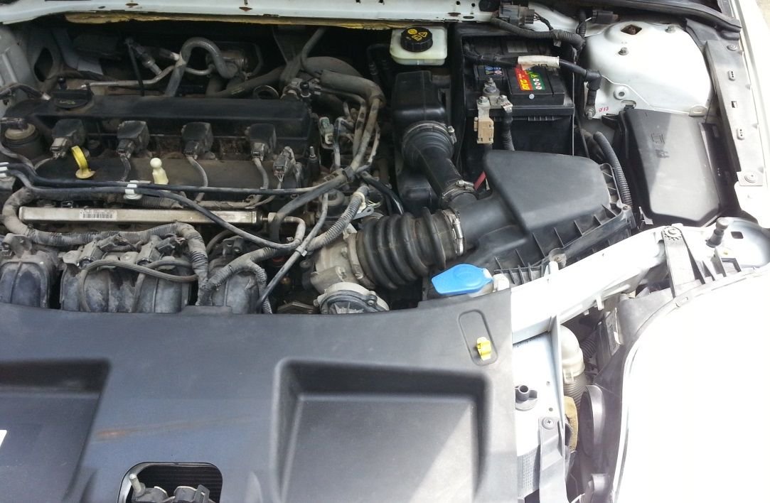

Enclosed are some pictures.
After dismantling the air filter box you can see an electrical connection on top of the gear box but, it doesn’t look like a typical backup (reverse) lights switch.

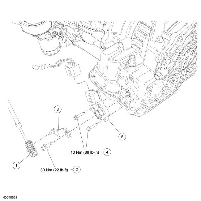

Ok wikipedia says that the same auto transmission in the mondeo is used in the focus so this is from the focus workshop manual.
Here is a picture for the location of the range sensor.
Here are the removal and installation instructions.Removal
  1. Disconnect the Transmission Range (TR) sensor electrical connector and the selector lever cable.
  1. NOTE: Failure to hold the manual control lever while loosening or tightening the manual control lever bolt will transmit rotational torque to the TR sensor and shift mechanism.
    Remove the TR sensor (automatic transaxle shown removed for clarity).
    1. Remove the manual control lever.
    1. Remove the TR sensor bolts.
Installation
    NOTE: Do not fully tighten the bolts at this stage.
    Install the TR sensor (transaxle removed for clarity).
  1. Using the Transmission Range Sensor Alignment Tool, align the TR sensor and tighten the bolts.
    • Tighten to 10 Nm (89 lb-in).
  1. NOTICE: Do not use air tools on this bolt. Hold the manual control lever while tightening the manual control lever bolt, failure to the manual control lever shaft or the Transmission Range (TR) sensor could occur.
    Install the manual control lever.
    • Tighten to 30 Nm (22 lb-ft).
  1. NOTICE: Check the manual control lever is in position 2 (same as D position) or the selector lever cable will not be adjusted correctly.
    Adjust the manual control lever to TR sensor D position.
    1. "L" Low
    1. "D" Drive
    1. "N" Neutral
    1. "R" Reverse
    1. "P" Park
    • When in position D, the marks on the manual control lever line up with the marks on the TR sensor.
  1. Connect the selector lever cable and the TR sensor electrical connector.

Images had to be approved...

That looks like a different transmission then what comes in the focus.
Can you check the door jam sticker if it says what exact transmission you have?
I should clarify that I assume that is still the range sensor and that is what tells the PCM what position the transmission is in. Its just a different transmission so its in a different place on the transmission.
