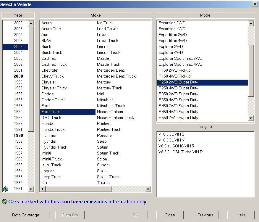

You said 2005 F250 super duty xlt but what is XLT I don't have a clue. When it comes to Ford you need to provide the engine size not the model trim. Check my signature below to see why.
Look above, OK button is not even clickable because engine is not selected, 4 possible choices.

Look at the 4 possible choice. If you have V10, either VIN S or V. S or V is the 8th character of your VIN number.
If you have V8, your truck is a diesel or not.

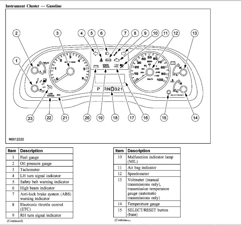

Number 10, verify if it proves out correctly (key in RUN light up, engine start goes away). If you have a scanner you need to plug it in and retrieve any possible DTCs.
You can also remove the MAF electrical connector, then start up your truck you must see the CEL or else your CEL bulb is bad.
