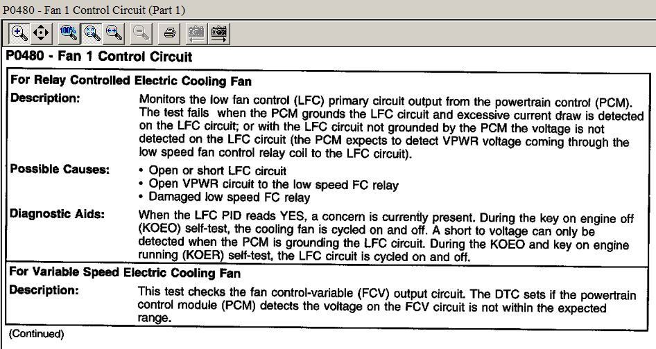

Hi. My car is throwing a p0480 code. I’ve replaced the fans and test wiring from fuse box up to the fan motors, all shows they are getting power. They turn on for a few seconds and turn off. I’ve been told it could be my engine temp sensor may be the cause, so I’ve be researching this. My question is, does this car have both a cylinder head sensor and a coolant temp sensor? I’ve read that it does have both? Thank you.
