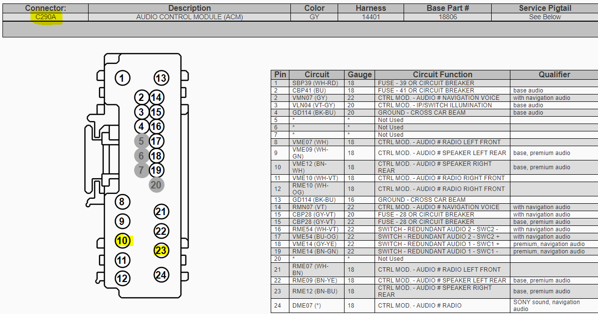

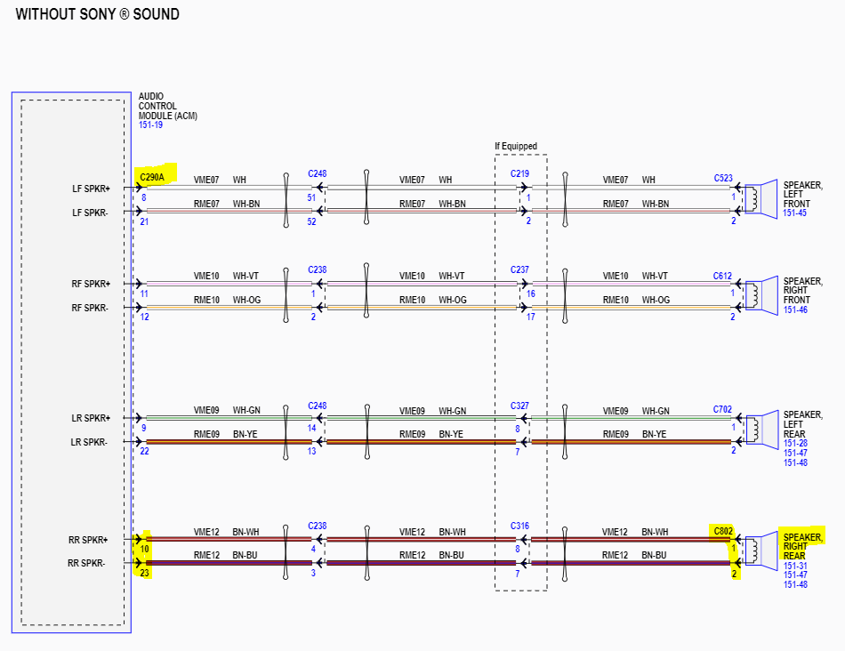

I have a 2010 f150 xlt super can. All factory radio with sync (not Sony system with subwoofer). The passenger rear speaker is not working. I removed the speaker and plugged it into the rear driver side port and the it worked fine, so the problem is not the speaker. I checked fuses, but if it were a bad fuse, I’m pretty sure more than one speaker would be having this issue. Any thoughts or ideas?

Check if either speaker wire is shorted to power or ground or each other, check resistance of each wire from end to end.
