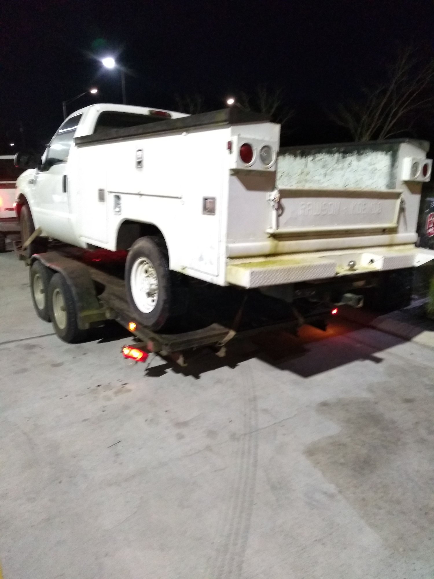

I found the 250 with service body parked up from the owner "trying to fix it" from spitting spark plugs for $700 but dropped it to $300 since he couldnt find keys.
