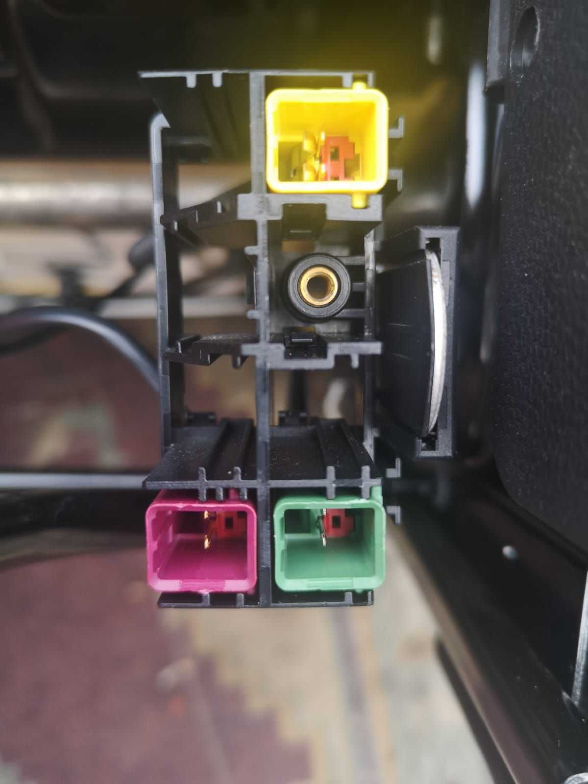

Has anyone installed bucket seats on a Ford Fiesta MK7.5 2014 82hp model successfully. If so could anyone explain what they done to bypass the airbags and get no warning light
Here is the plugs from under the stock seats

Welcome to the site..
Being it’s safety restraint devices, disabling is never advised, and you may not get a lot of response for that reason, liability....
The potential for personal risk and harm or worse, and system/hardware damage is present...
That said,, Airbag simulators generally use 2.0 ohm resistors for system detection ‘desired range’ . With simulator/s plugged in to the connector to prove out the device before live bags/pretentionersioners are again installed. Ohm loops are matched and detected..
