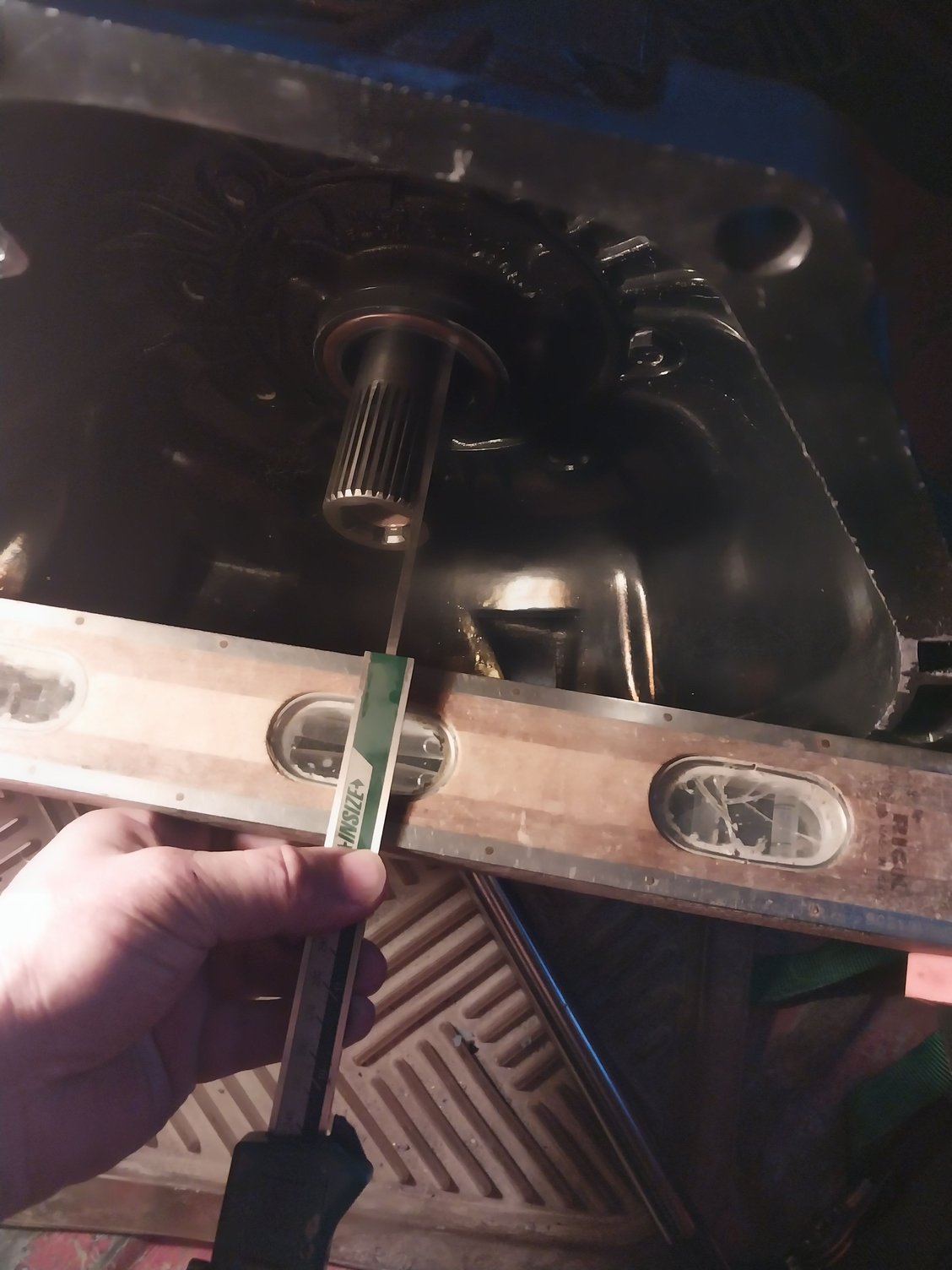

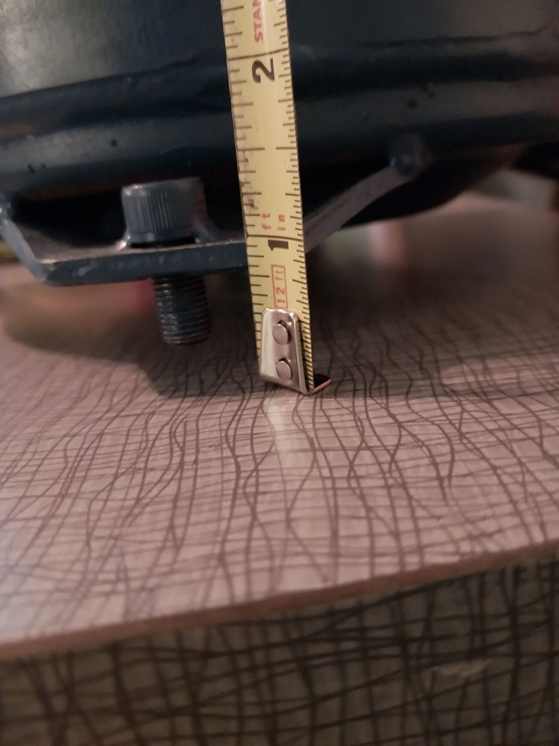

Spec question, back of my pump is 6.5" from bellhousing edge, torque converter is same length. Pads only fall 3/4" inside bell instead of the 11/8 " I need. This is after a shop rebuild. Any insight on where my clearance went to bolt motor to trans? I'm at 2mm of interference instead of having 1/8" to draw to converter to the flexplate.
