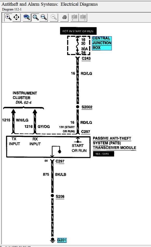

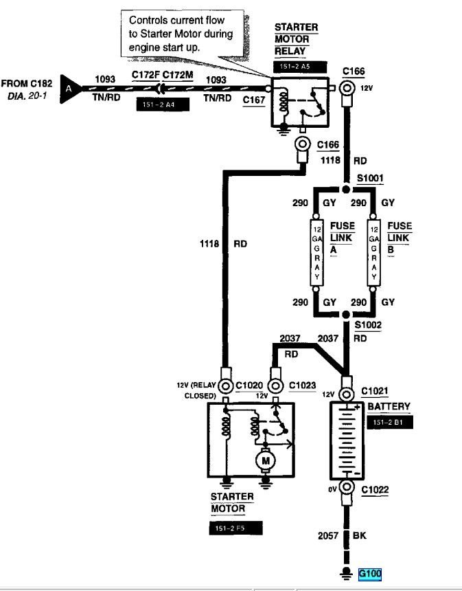

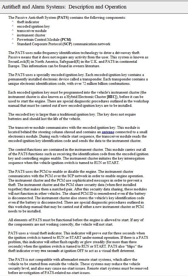

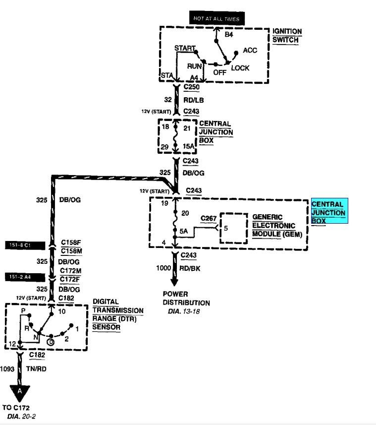

If the PATS system just do starter interrupt (no crank no start) and fuel pump power cut (crank no start) that would be easy to bypass. Unfortunately look at above description it mentions SecuriLock system (crank no start even if you bypass the starter interrupt). I believe it's possible to code it out and disable it. So wherever you buy the PCM from you might want to ask if they can code PATS out. If you look at the first 2 diagrams above on the starting circuit it doesn't show PATS gets involved at all.
