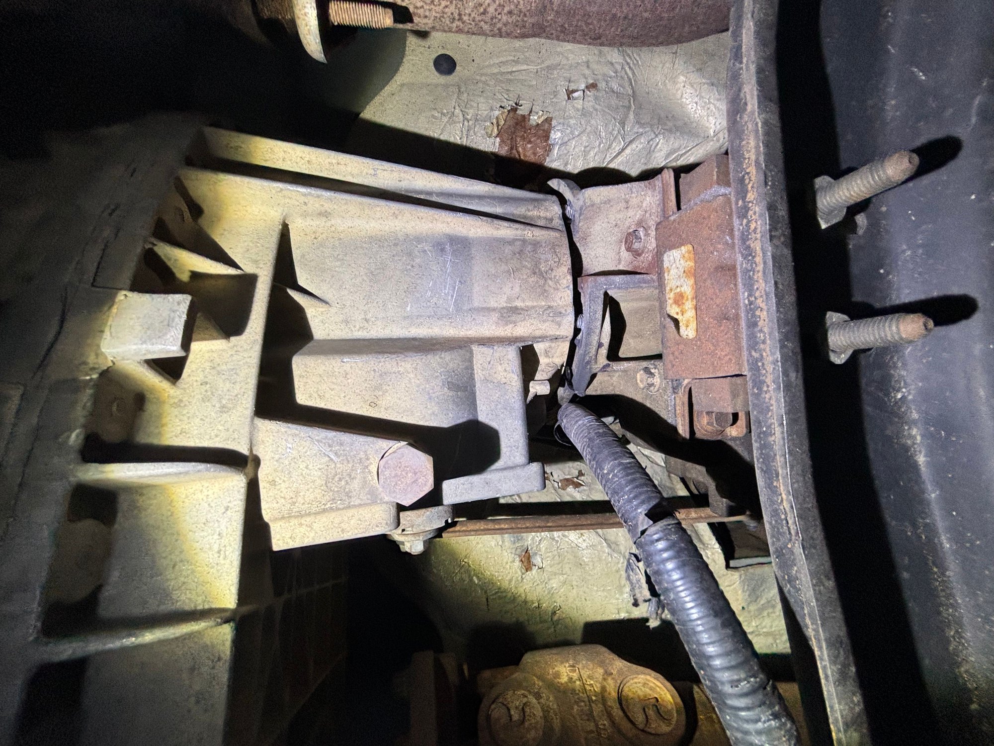

My extension housing cracked so I replaced it. Just a few months after that do you joints in my wobble loose fell off so I replace that couple months after doing so my extension housing cracked again. I replaced that ,month after that my driveline you joint started wobbling again what would be the cause of this reoccurring issues?

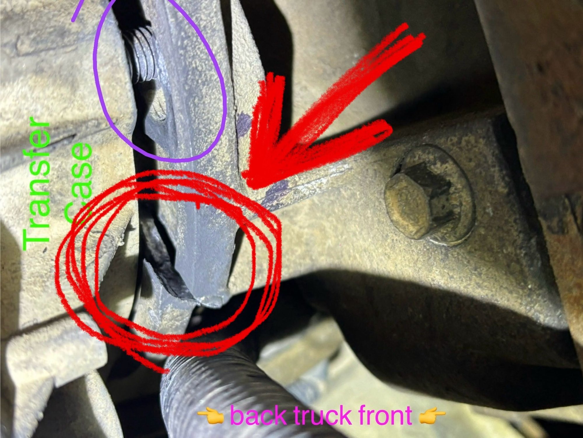

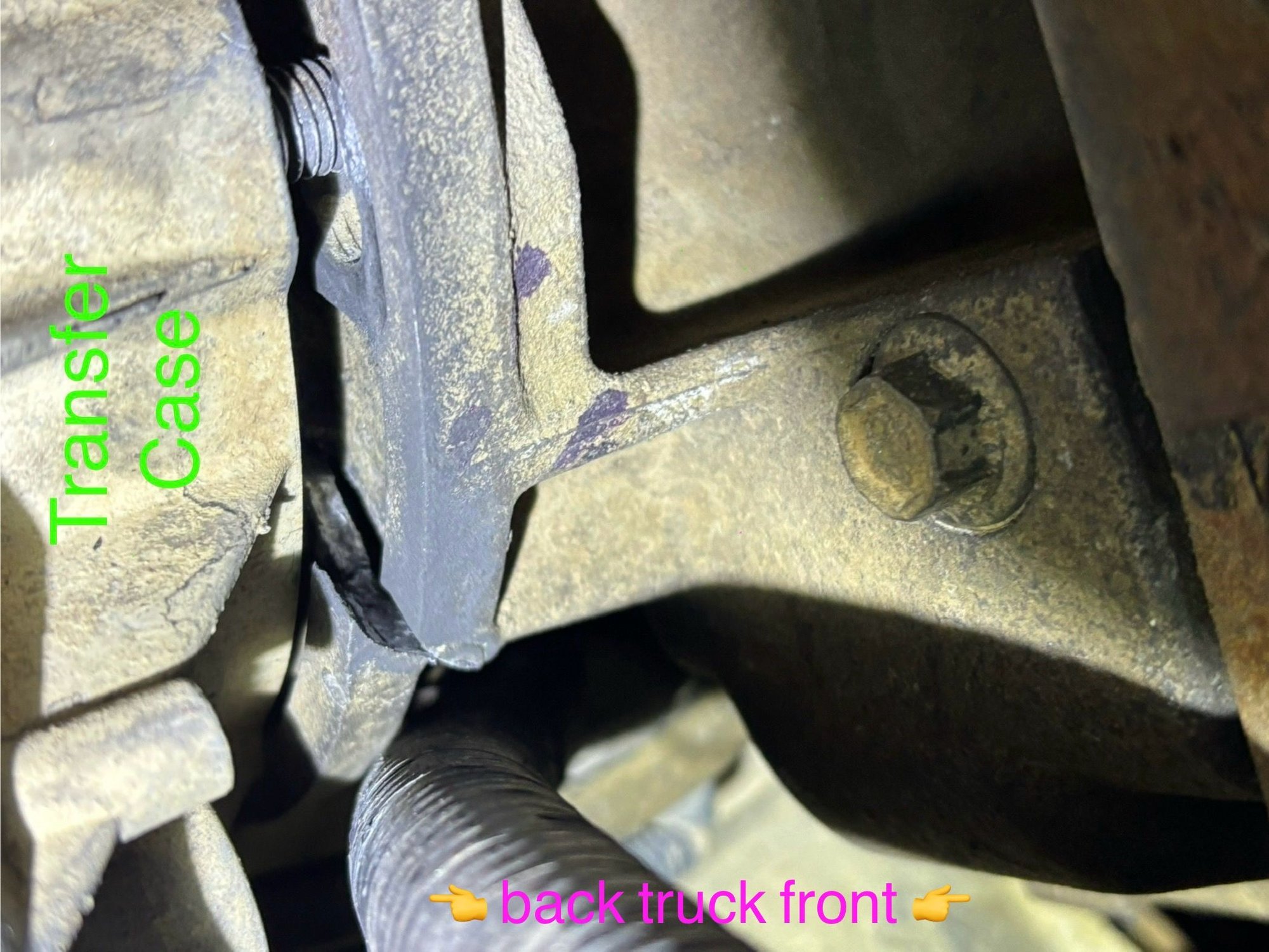

It cracked and actually had two sizable pieces of the lip face that connects/bolts to the transfer case. One of the pieces was still connected to the transfer case by the one bolt that held that broken piece

That's the cracks ,
and I just tried to do the motor mount check and didn't notice much movement....
my bushing to my tie rods and co tool arms on the front are worn so that is gonna be a definite upgrade soon ... would them being old and loosing elasticity and strength be a possible cause to my extension housing and driveline issues

I( would say you hit the nail right on the head.
It does appear the front drive shaft tried to move the transfer case rearward and the mounting didn't agree.
Make sure to check the entire mounting of that forward axle assy.
