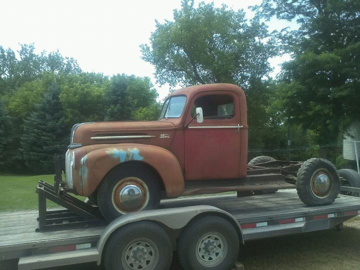

New to forum - life long Fan-72-f100.jpg[QUOTE]
lets see if this worked

[QUOTE=Knute;74153]Attachment 801
Attachment 802
Got your hands full
I'd love to find a 70's pickup for my 'going to town' rig. That 47 would be a blast to build!
Looks like a couple of pretty solid examples of Ford iron. Keep us posted on any progress.
