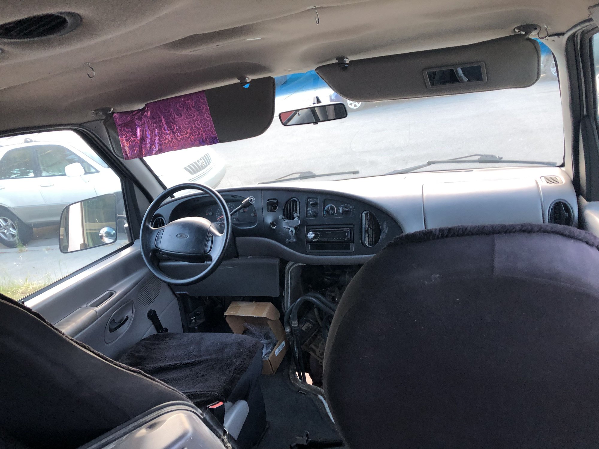

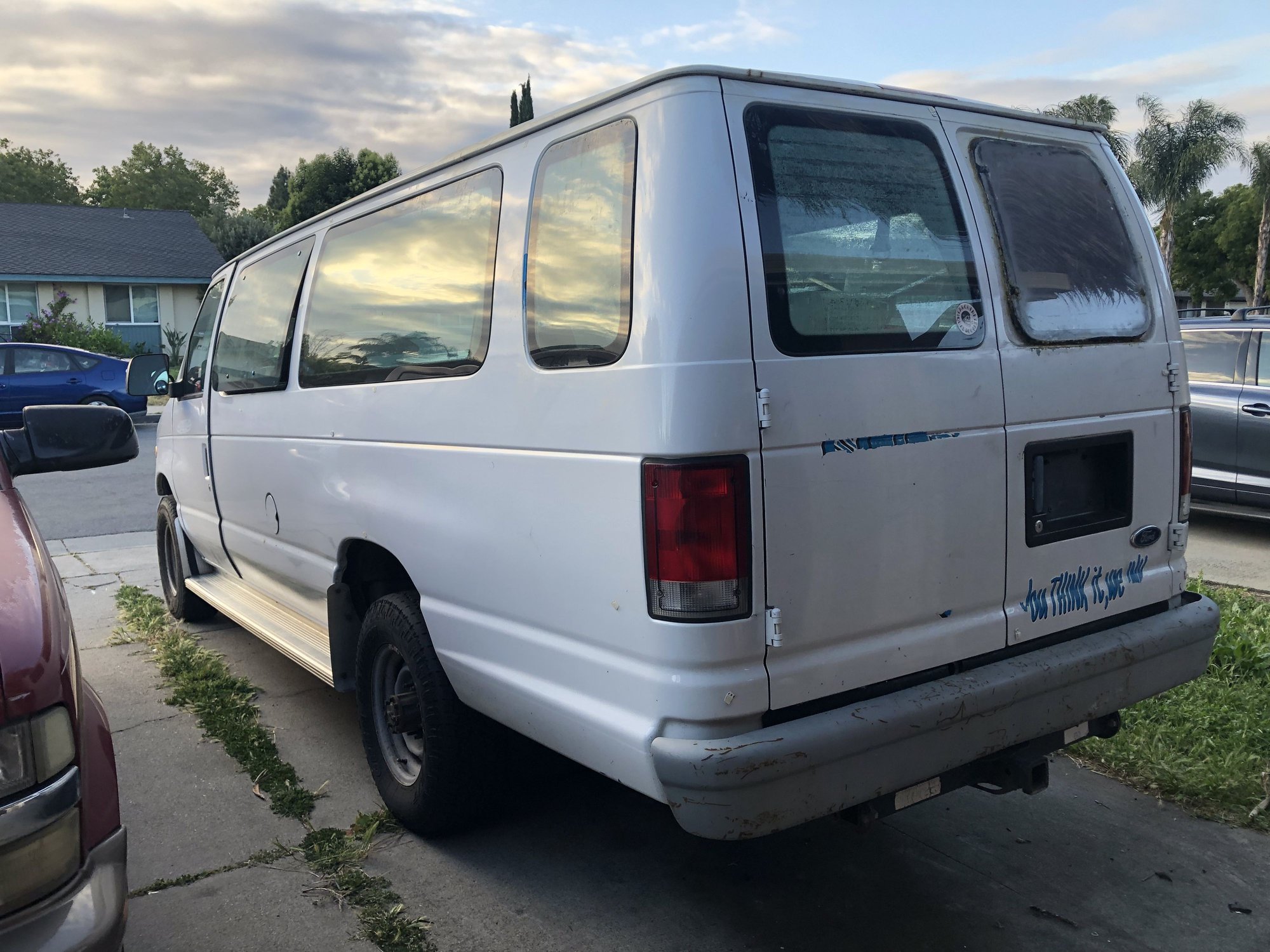

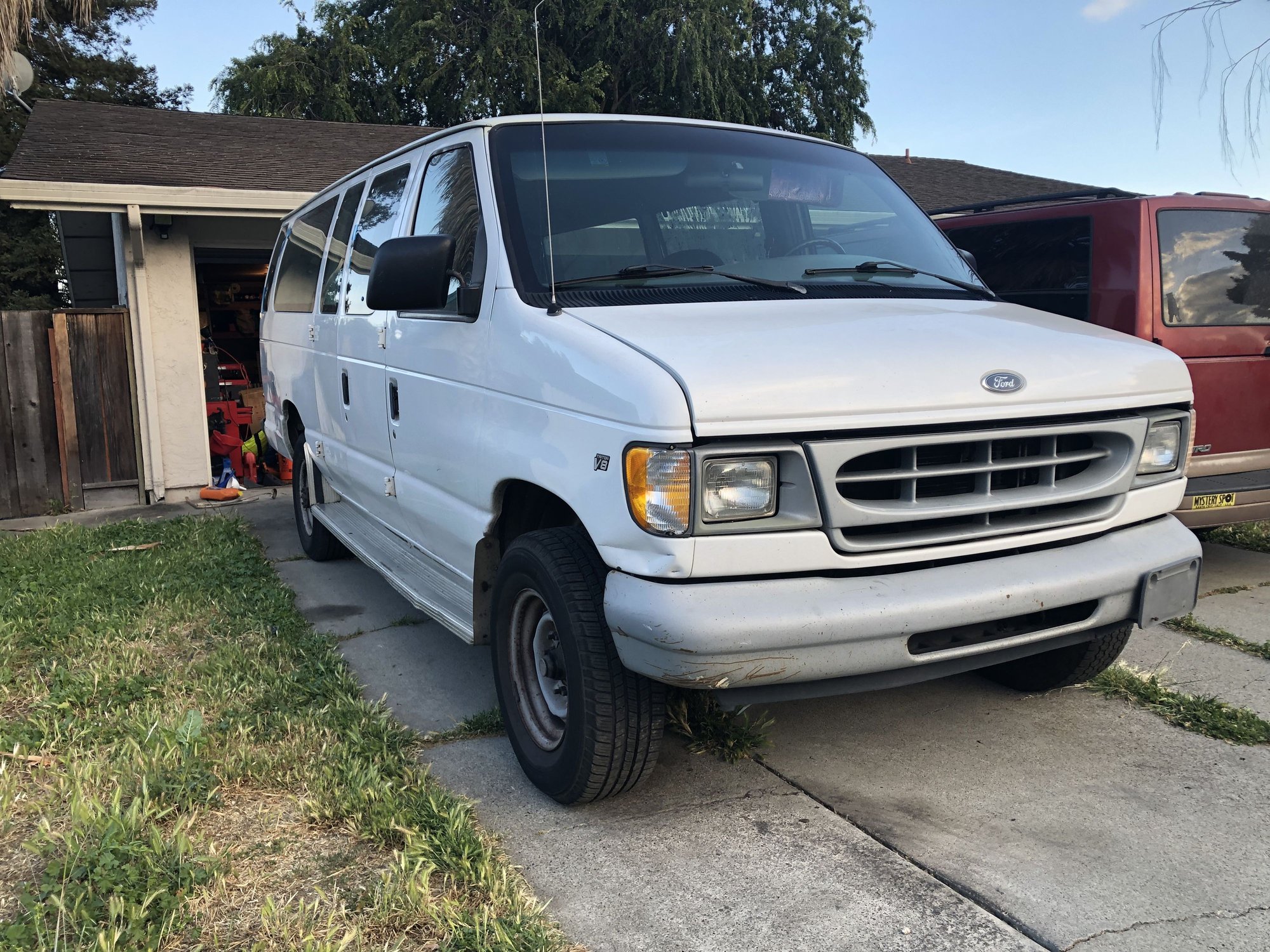

Replacing the rear passenger side door?
Replacing the interior trim? (she cut alot of the trim)
Installing seat belts.

If ,,, you want to, get a fiberglass repair kit and you can easily repair the rusted problem with the door. It is quicker and cheaper to repair it, then to replace the door..
You could get an estimate of what a body shop would charge to repair and paint the door. That might help you make a good decision.

Thanks ill look into it... the main reason is that window... I thought if i can find a door at the junkyard it would be relatively easy, but i will look into getting a new window.

OK, that window glass is held in place by the rubber seal that goes around it. It appears to be missing.
This is what I would do,
First see if a dealership has or can get you that rubber seal. If they cannot help , try an automotive glass place, either they can install it or you can, it is not difficult at all.
I can tell you exactly how to install the seal, then the glass and you would be done in 15 minutes.
The only tool you would need is a can of WD40 and a small putty knife to slide the rubber around the glass. Don't remember , some also had a filler rubber strip that you slid in place to secure the glass, no big deal.
Plenty on eBay, used around $60, brand new around $82 like this. You want OEM used in poor condition or brand new aftermarket at your choice. You just need to buy the hardware bolt here and hexagon nut from any hardware store separately.
The one you have on your van you can tell it's not even the correct shape, way too small without the tint, and uneven cut on the bottom.
Installing the new one should take 5 minutes. What takes time the most is cleaning the leftover adhesive mess from the existing one.

Thanks for the knowledge... and ya whoever did that window looks like they used guerilla glue around the seems. there is also glue on my headliner that i will be attempting to clean.

If you decide to replace the whole right door, it should be around $150 to $200 at the junk yard, and the window is included, so you might want to hold on to just the window.
You have a 99 E350 passenger van, and I have a 98 E150 cargo van. Yours looks so clean on the body and you make me so jealous.
I notice you have a phone mount at the vent, I don't recommend that sooner or later your air vent is going to break. Instead you should get something like this:
from aliexpress, I am using this without the holder that came with it and into my cigar port (the bottom), not the power port (on top), I'm using a different holder, what I care from this one is the universal ball mount on the back of the holder, and the flexible neck is actually very sturdy. Note on our vans both cigar and power ports have always-on 12V power, so on the cigar port I modified it to have switched power because there is a blue LED indicator (draining your battery) on where the extra USB-A plug is.

Thanks, The van body is pretty clean, maybe my cleanest project car yet... i cant wait to polish her and see what it looks like. The lady I got it from actually glued the phone holder to the vent smh.
