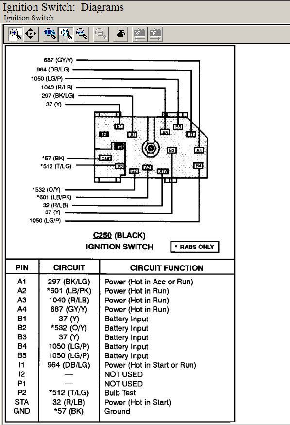

Not
urgent but just wondering where the ignition wires are on a 1997 ford f150 v6 10th gen doing an ignition cylinder swap and don’t see them?
Old May 25, 2025 | 06:50 AM
You might want to look at the lower part of the steering column near the brake pedal.
Old May 25, 2025 | 10:06 AM
How urgent and which exact wire are you trying to located? and Why?

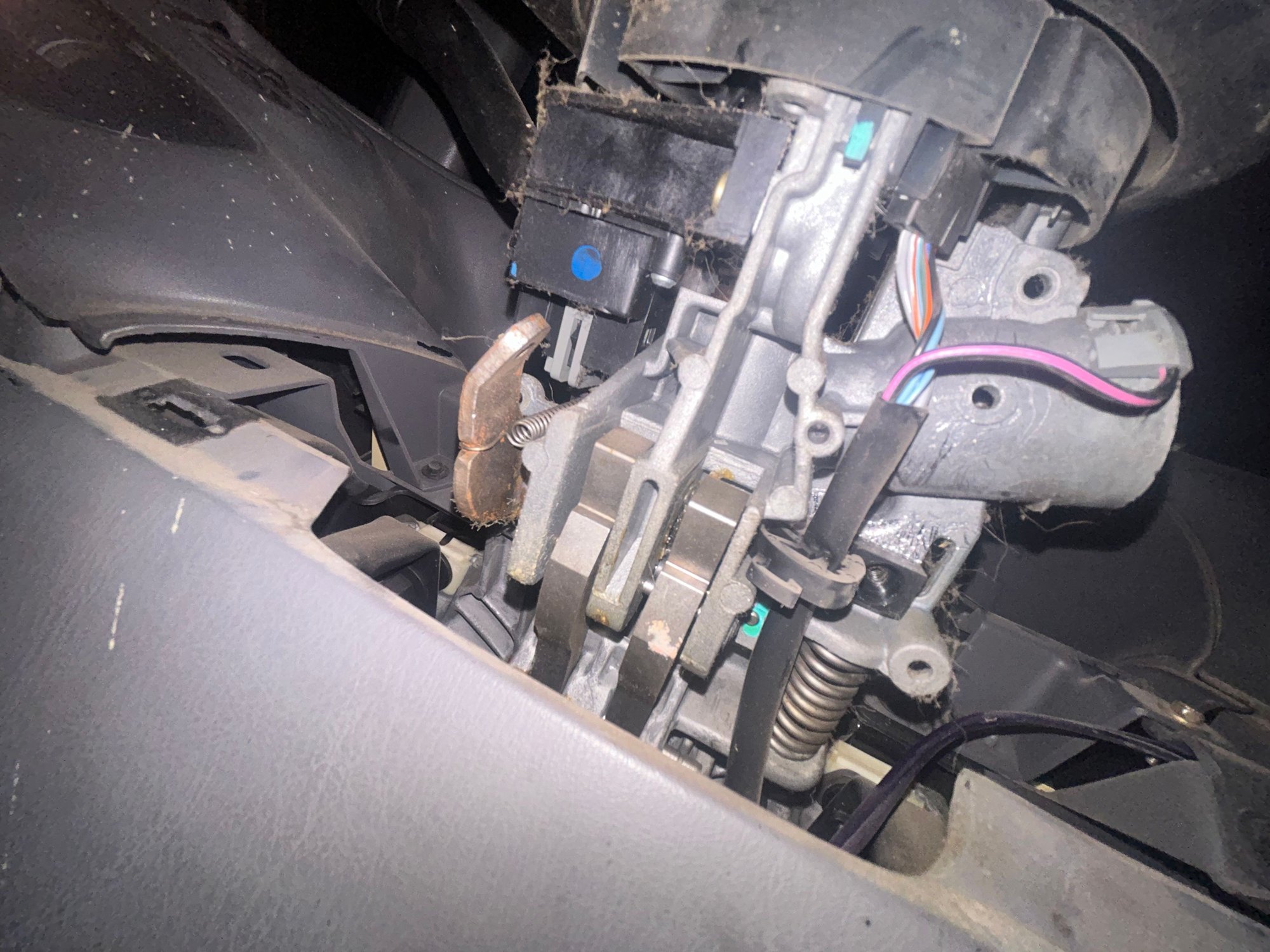

Old May 25, 2025 | 06:41 PM
The lock cyl when set to accy position is supposed to index with a gear that moves a rack that moves the ign sw assy..
Sounds like the gear dropped out of mesh with the rack..
Most shops don't usually get involved with this type problem and will just get another strg column from a salvage yard. It is not a job for a novice, but if careful and have the patience, you might be able to reinstall that gear IN THE PROPER POSITION. Does require some watchmaker ability. See if a local locksmith would want to look at it for you.

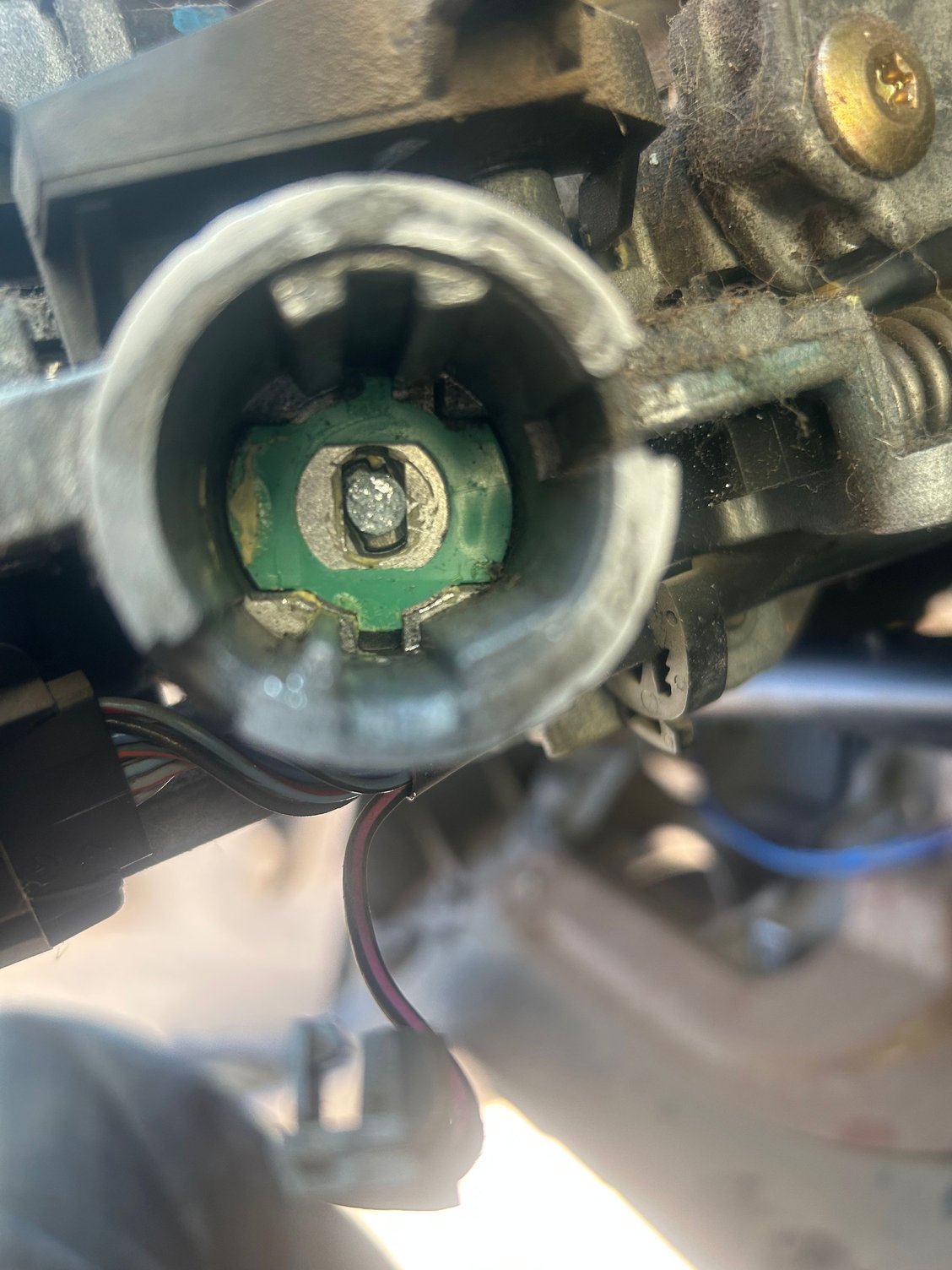

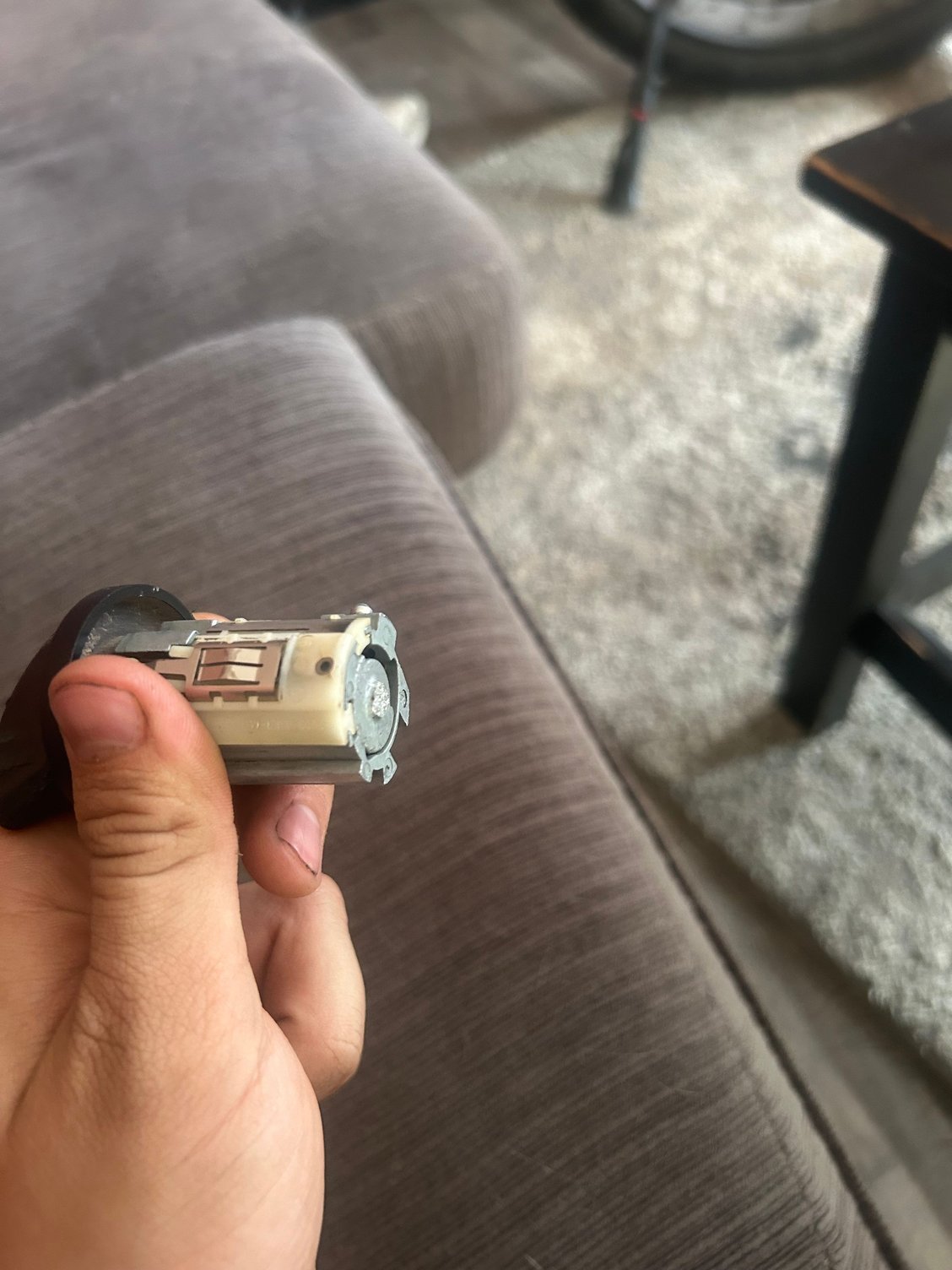

Hey sorry for the spam but did a chunk of my ignition break off?

Does that mean the steering wheel doesn't lock anymore?
You said you need hot wire, you still haven't told us why. Is it because a no crank no start, or issue with your ignition lock cylinder or what.
Ignition lock cylinder is no magic, you can simulate most of the actions by your fingers. Simply separate the ignition lock cylinder away from the ignition switch, then manually move the **** on the ignition switch to STA position, and release your finger the spring return will return the **** back to RUN position. Your concern is starting, can you start it this way? If not, can you start it directly from the starter solenoid?
Ignition lock cylinder not engaging correctly with ignition switch, that's a next topic.

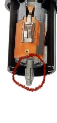

That broke off section is to engage with the **** on the ignition switch. Simply remove the bolts of your ignition switch, you don't need to remove the entire electrical connector of it. You might need a helper to use a flat head and push from the ignition switch side, you get the broken chunk out using needle nose pliers from the ignition lock cylinder side. You might need to wiggle to get it out, that's why you remove the ignition switch and disengage them first.
