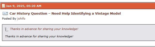

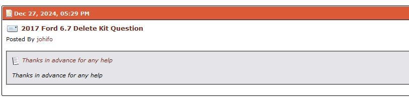

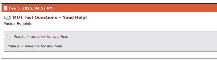

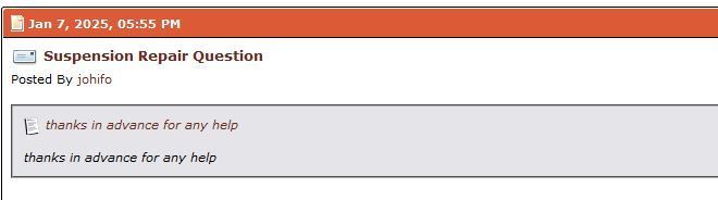

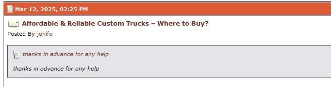

Old Mar 25, 2025 | 02:40 AM
Posts: 1,243
Once is enough, not 7th.
If saying "Thanks in advance for any help" is a must:
1) consider setting that as your signature
2) you can append that to your original post by clicking the edit button
You are merely wasting fordforum.com resource, it's absolutely unnecessary in such way to earn more post count.
