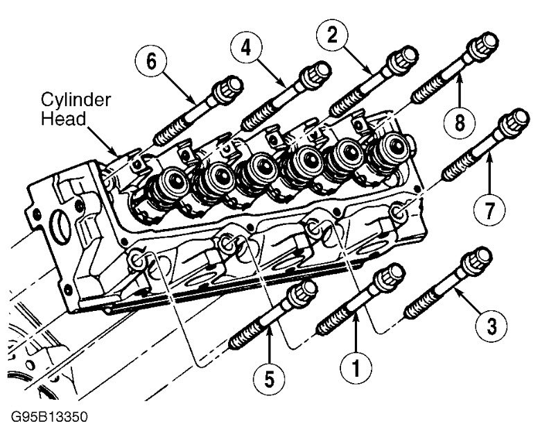

OK did you torque the head bolts down in right sequences and did you use the same bolts when you put them back on? Another thing did you do it in three stages when you were putting the bolts back in or did you just torque them down all at once. Some people don't have the patients to wait while doing something like that.

New head bolts were used, and there are actually 5 stages.
37 ft lbs
loosen 1 full turn
22 ft lbs
90 degrees
additional 90 degrees
and I used the sequence from the attached image
Attached Thumbnails Trying to troubleshoot Mercury Sable 3.0 OHV (Vulcan)-large.jpg
