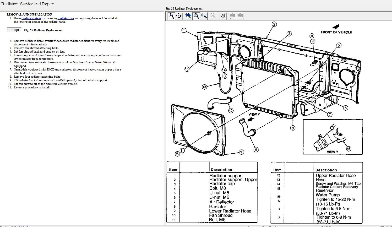

1994 E350 , coolant line is leaking by the radiator (lower). Also the radiator loses coolant at same same time but no signs of it leaking. Question, does the rubber hose come off or do I have to replace the whole tube? And why would that effect the radiator level? Do I need a new radiator besides the coolant line? It's a 7.5lt 460. E4OD

There is a cooling spiral inside the radiator that transfers trans fluid heat to cooling system to be removed by normal cooling system function.
If you need to have the radiator removed for repair, they will pressure test that trans cooler also to verify no trans fluid can get into cooling system.
Trans fluid press in area of 75 psi, cooling system press in area of 15 psi,
