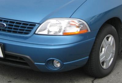

I'm not 100% sure but do believe they were round. Seem to recall it looked like the attached image. Unfortunately they were down here in MD for vacation but are now back in NY with the vehicle so I'll have to verify.
Seems odd that there would be no logical way of switching on and off if they are auxiliary driving lights therefore you have me second guessing that they could be turn illumination. If they end up being driving lights would they be manually switchable?

I was just advised the lights are indeed round which should identify them as auxiliary driving lights. So that leaves me wondering how they are designed to operate. Can they be manually turned on/off or are they in some form automatic. As far as I know my brother-in-law has never seen them illuminated and still can find no switch or owners manual documentation to their usage.

They are indeed driving lights I have the same 03 blue winny as the picture the lights are round and are on with the headlight switch there is no other switch .Its the wifes car and shes not home yet but almost positive they are on when the markers are on also when the headlights are on and I think even high beams they are on, Go simple and check if the bulbs are good first,it tells you in the owners manual all the bulb numbers,

Just what I needed to hear. Very good possibility it could be burnt bulbs or corroded sockets. The vehicle is from northern NY (2 miles from Canadian border) so likely has seen quite a bit of winter's ravages. I'll pass your info along, it should provide him with what he needs to get them working...now that he knows how they should work!

confirmed ,lights are on all the time ( with switch) bulbs look to be a #912 but need to confirm ,good luck
