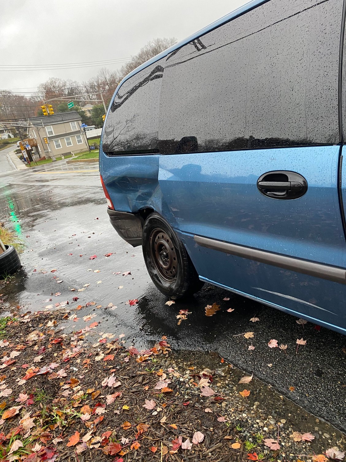

Okay so a while back my 2002 for windstar took impact to the passenger rear tire and slightly the panel above it. The tire bent in to where it was rubbing the coil spring. But why won’t it run after that now? Is my whole rear axle screwed because the wheel bent in? Should I just get a whole new axle assembly or what, I really need some advice on this
That’s the impact

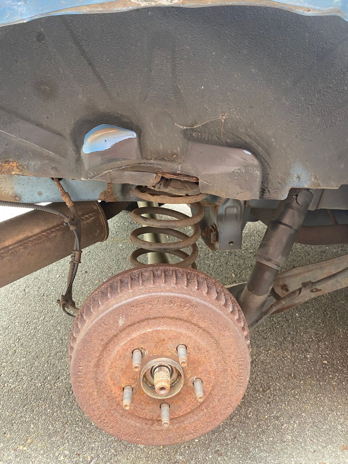

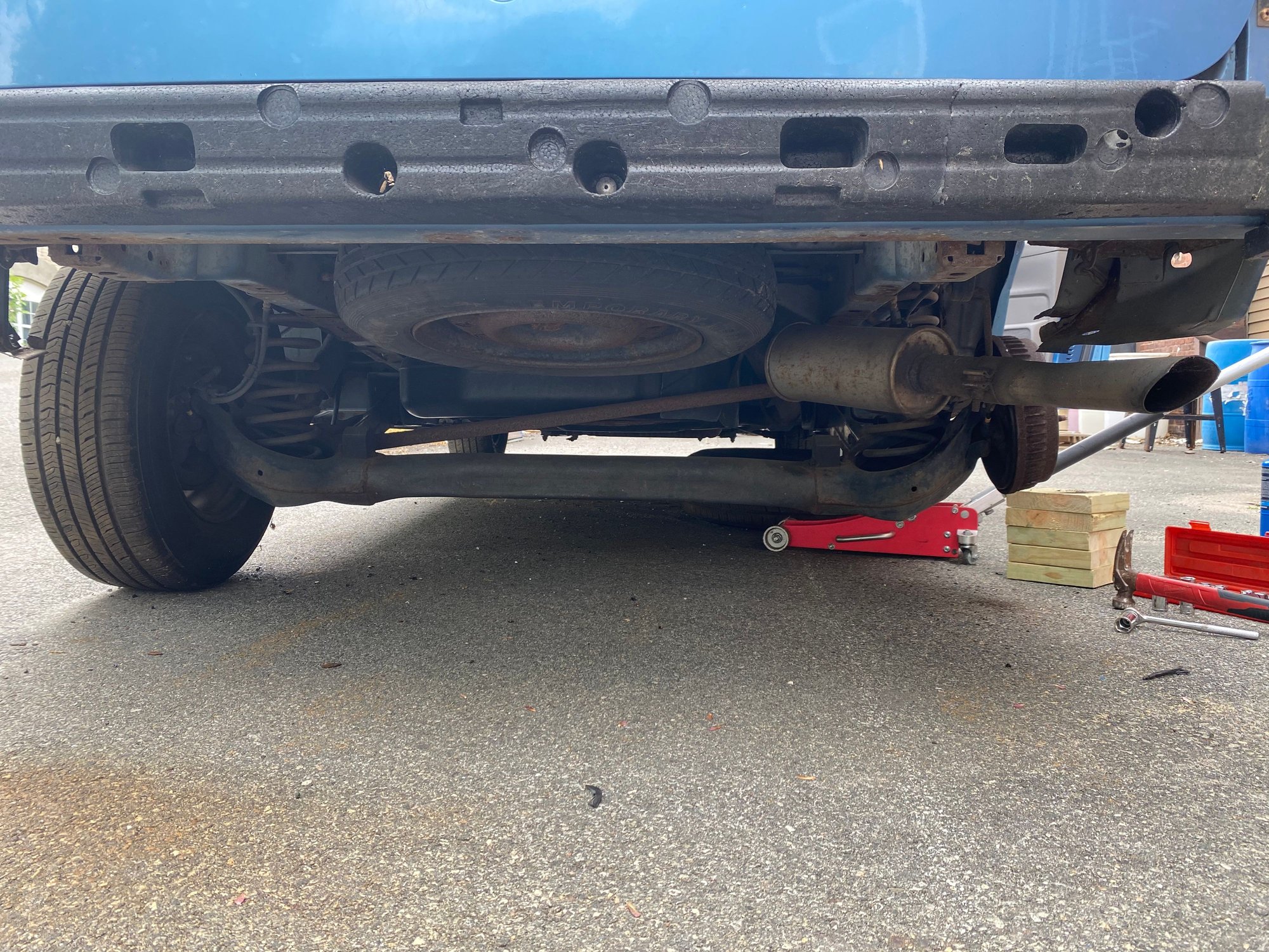

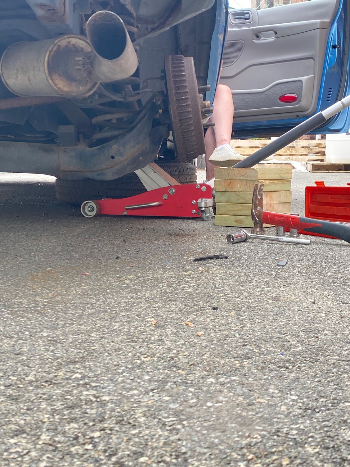

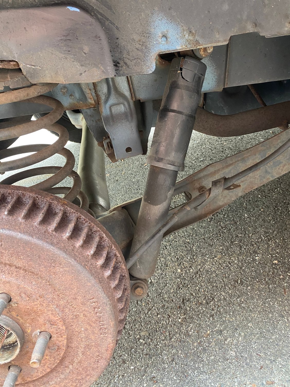

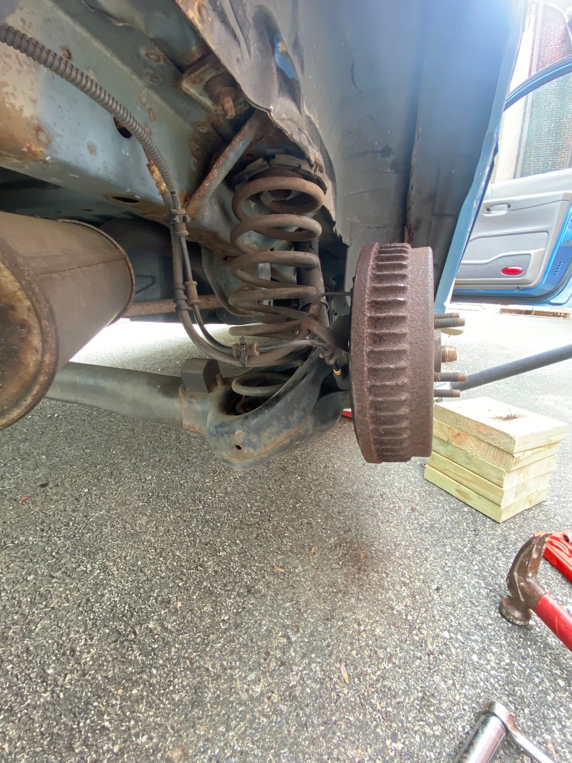

More pics for detail

U can see how far the wheel pushed in you can see the rub mark with paint showing
The inertia switch was my starting issue solved that today but this is my real issue

From what I believe I saw , there are 2 bent parts. One is the bar and channel that goes over the bar that goes from wheel to wheel. The other is the strut that connects the right side of the axle to the body. They both appear to have a bend in them, maybe it's me , but have a good shop check that out.
