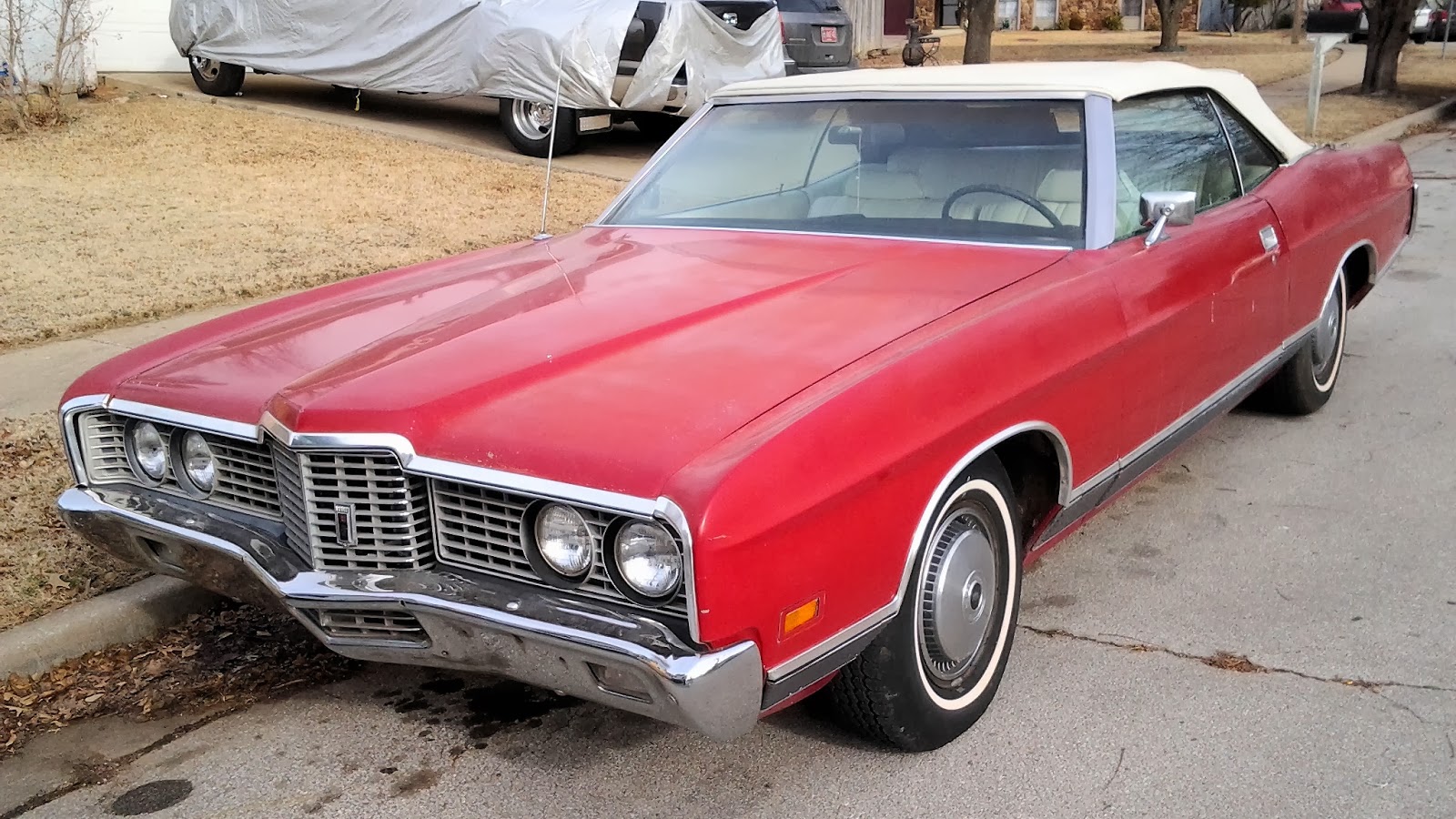

i been calling some places an emailing others. like i emailed air lift to see if they have something to help hold up my power wheelchair on class ii hitch mount. i also called some local repair shops about paint, brakes, an a/c. it has factory a/c in both convertibles. i know in the 72 ltd both heat n air don't work, but not sure on the 65 galaxie. i know a/c is a interesting consideration but i have a sensitivity over heat. if i get to hot i can get extremely sick and end up in a hospital. the convertible part will help a lot but in 90+ ill probably need a/c. as for brakes the 72 ltd has front disk/rear drum and 65 galaxie has drums all around. the repair shops cant give me a idea to install brakes or a/c without seeing the car. and to paint the cars maaco said to fix the rust and paint the 72 ltd would be $1500. and it would cost 1300 to do galaxie + under the hood. see galaxie in primer but hood is replacement from a white car. this is all using maaco's best paint system too. if i went to single stage urethane paint the cost would be cut by 1/3 of the cost. but im thinking it would look better with a base clear.
anyways u can see i been doing a lot research. one reason for all the research is because i live on disability and there are some weird rules. like i cant have over 2 k in the bank longer then 10 bigness days. and i have to show recites proving i spent it or lose my disability. they don't count owning a car as a luxury because i need one to get to my 2-3 dr appointments a week. but if i owned 2 cars or spent on computer or tv then im having luxury and risk losing my disability. so that's why im looking at a classic i can make a nice car.
thanks in advance, alice
p.s. im ataching pics of galaxie and ltd im looking at.

think my idea is reasonable or would the 72 ltd with tilt column new top n boot, in red paint and slight rust in lower rear quarter behind wheel under trim be better deal for $5,800?
ltd has a blower that is noisy and no heat or air working. galaxie just needs ac charged with r134a

Alice, I am biased here. I like the Galaxie better than the LTD. That LTD looks bloated, the Galaxie looks classic with the vertical double headlights and crisp lines from front to back. The LTD's Knudson nose aka Bunkie's Beak makes me sneeze! But that's me.
I am thinking of it this way: my budget requires me to spend money so the money keeps coming. I would not care how long it will take me to get the Galaxie right. I would buy it, get tires and shocks and all fluids so I can drive it. Next project would be the hitch for the wheel chair and ride height adjustment. Next step: new top cloth. Next step: rear quarter panel. Next step: paint.
If you like the LTD better, do it the same way with it. They will cost you money one way or the other. So make sure you spend it on the car you like.

i like the look of the galaxie better as well. the 65-66 are my fav years. but sadly i got a call from dealer asking if i wanted to make a deposit because he has someone interested. but what i could afford wasn't good enough to hold it till the settlement comes in. so it may not bee there when i get my settlement. the ltd is my backup plan. galaxie had the 352 big block too. but ltd's 400 small block is a nice runner up.

If the engine in the LTD is the small block it's not the original engine. most of those cars had the 351 cleveland meaning it was a big block and looked like the 400's but either case those cars had the big block engines. They had to have enough power to push all the weight down the highway. one thing to remember is that was the last part of the muscle car era. and the small blocks didn't have the power the big blocks had. as far as the Galaxie that was the beginning of the muscle car era and there wasn't any rules which means that they could have any engine they wanted in it both the galaxies and the fairlanes were twins one just had more chrome on it.
