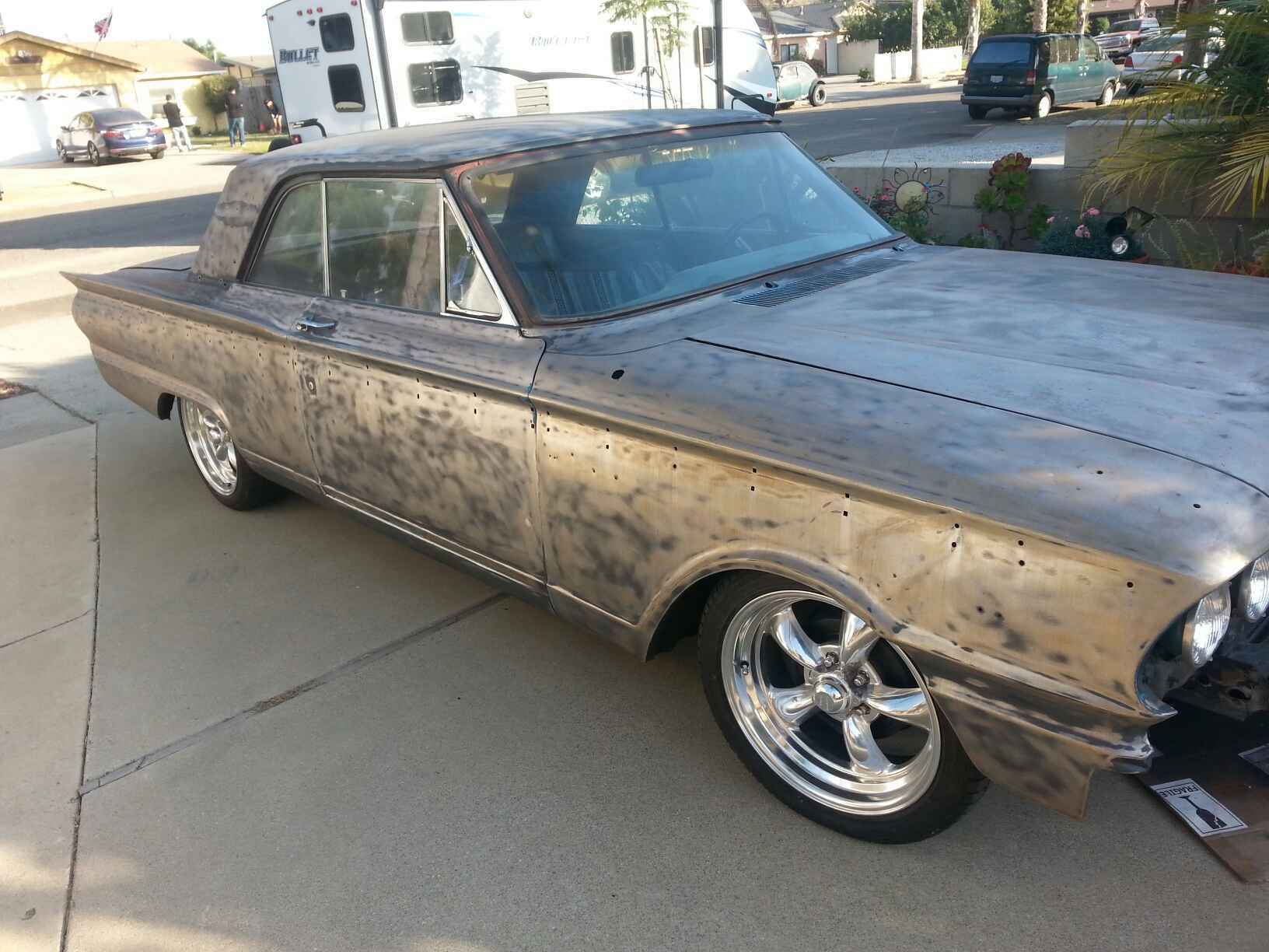

I'll make sure to check those out when the time comes. I've been busy (not busy enough) but getting there. Have it down to bare metal and will start body work sometime this weekend. I found a few bondo areas that I think push/pull out so I don't use so much filler. My goal is to have it ready for paint by Mar-Apr 2020. I can only get to it on weekends so we'll see. I'll post up progress pics. Good week to all.

Old Mar 20, 2020 | 10:29 PM

With some new paint and those wheels it's going to look sweet. Roger

Thanks Roger,
If things go the way I'm planning, paint should go on Sept/Oct, I hope. Sorry for the late reply, I have other projects, truck, motorcycle,etc so I jump around from site to site when I can.
