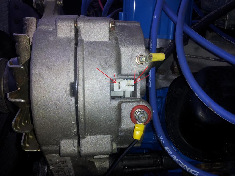

I just put a 91 crown vic 5.0 police interceptor motor in my 1968 Falcon and I have everything hooked up except the alternator... having problems figuring out how the last 2 wires hook up... on the attached pic the arrows point at 2 connectors on the alternator... where do the wires that hook up to this run... on the 302 engine that I took out of my car the alternator had the same amount of wires hooked up... got the bat wire and the grnd wire hooked up but on the other alternator next to where one of the wires was connected was written FLO (the O could be a D.. not sure) and the other wire had an S by it... what I'm asking is, which one of the connectors in the attached pic is the FLO (or D) and which one is the S wire

The terminal at the front, towards the alt pulley is the FLD terminal, of course the rear terminal is the STA term.

Thank you so much
