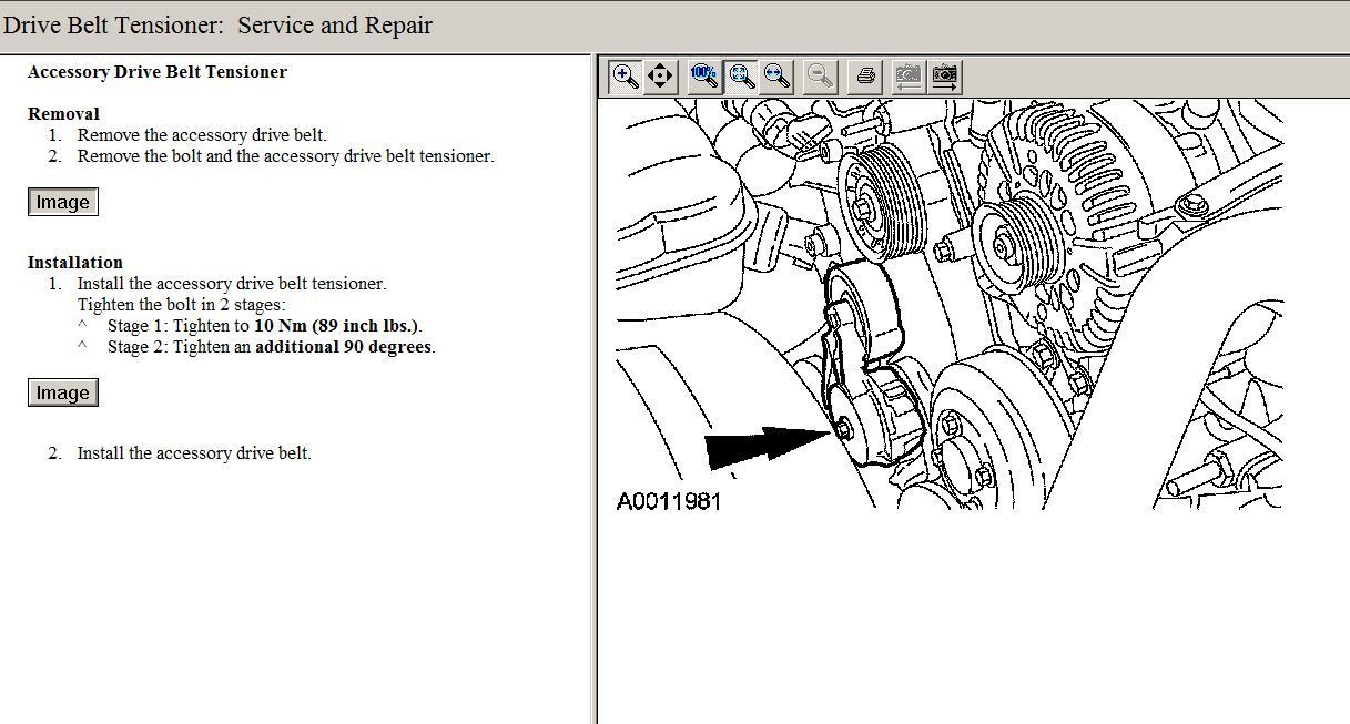

And don't replace just the belt you need the belt tensioner, idler pulley and alternator pulley at the very least and perhaps additional pulleys if they don't spin smoothly or making noise.

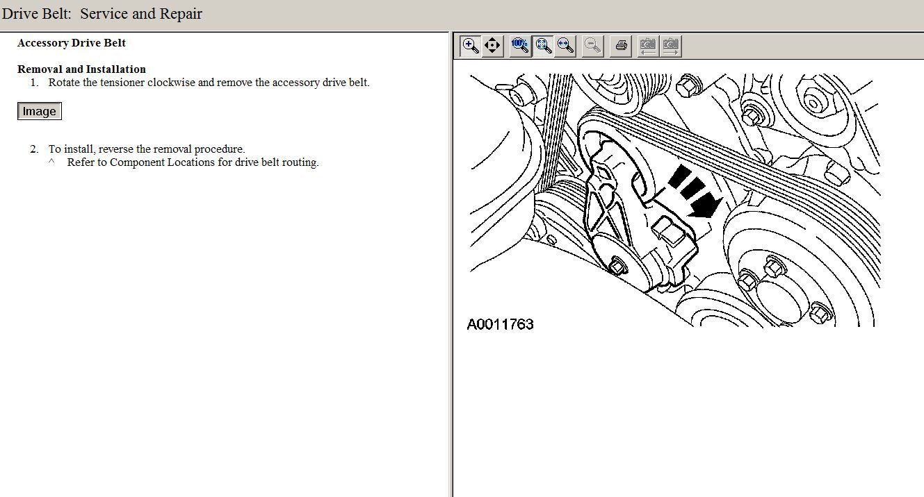

Default removing belt ?
How do I remove the belt?
My 2008 p71 is making whining Noice when started and it goes away after 30 sec or so. I would like to inspect all pulleys and so on. Belt looks good.
Old Feb 9, 2026 | 09:24 AM
Posts: 16,670
You have to move the tensioner against an internal spring . If you don't have the tools to do that, better to have someone with the proper tools check it out.
