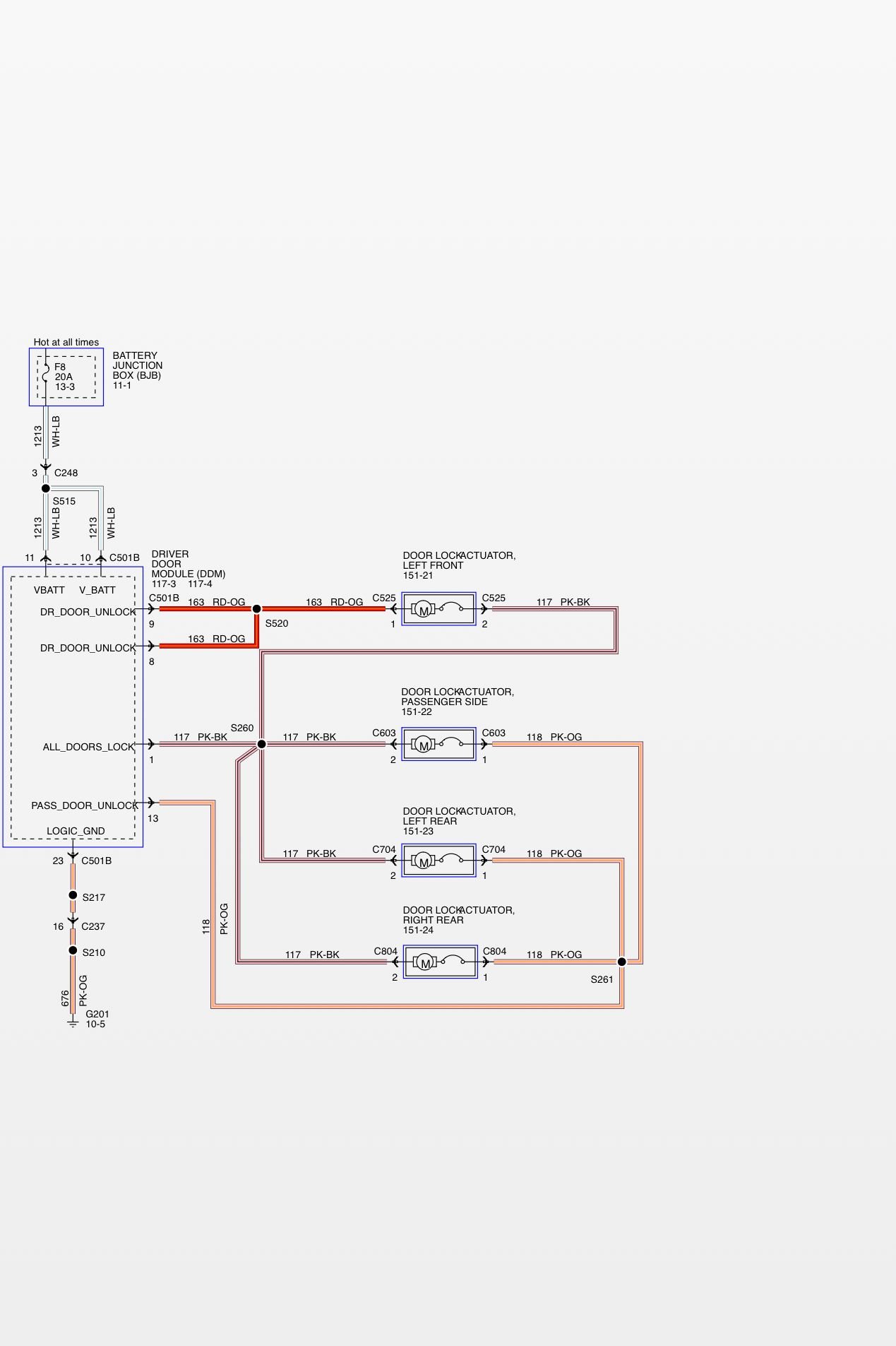

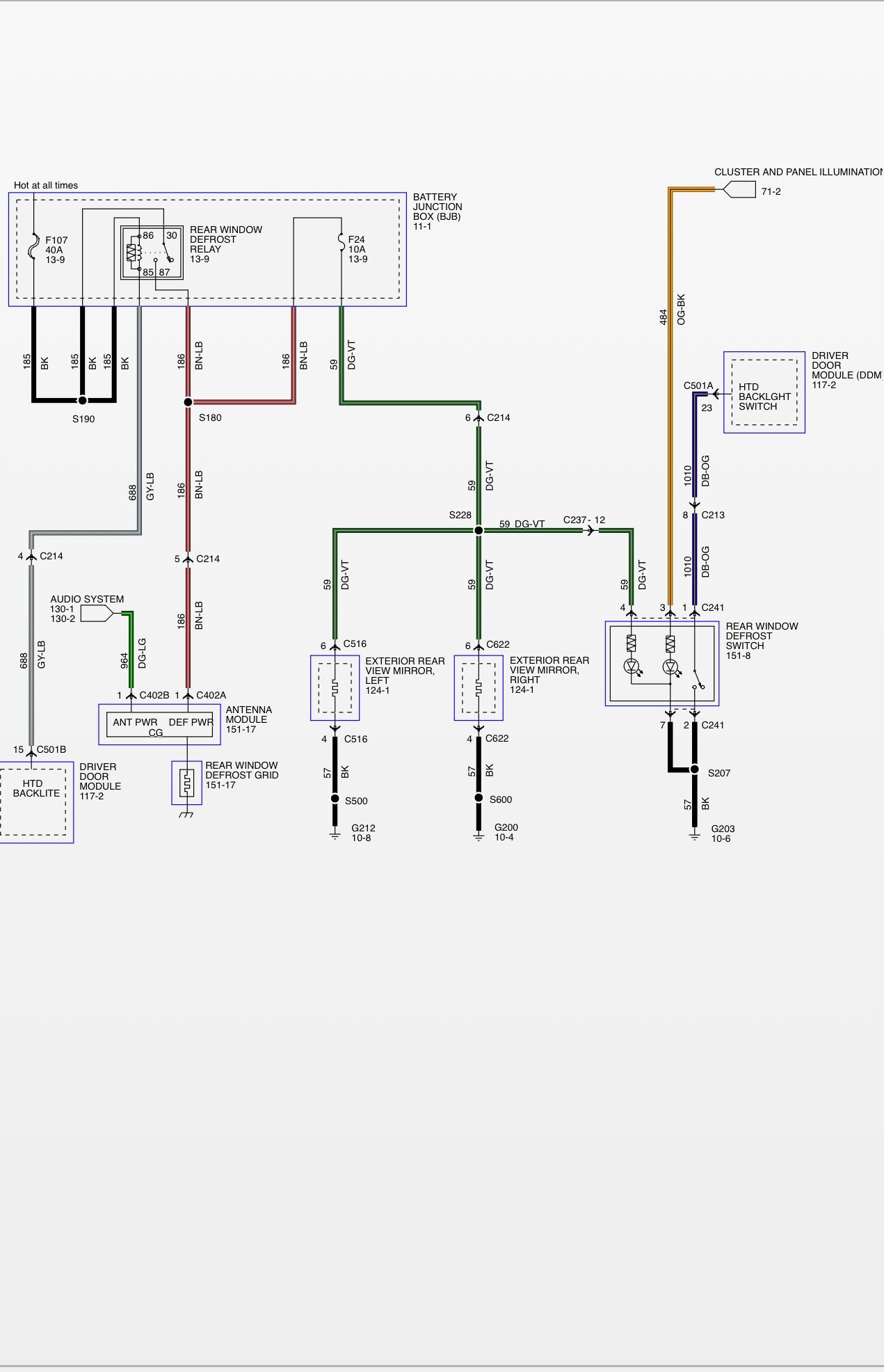

I've been searching t find out if there is a BCM (body control module) for my 2010 P7B. I'm having some issues with my warning lights, door locks, and rear window defogger. I has been suggested I look for a grounding issue. The first being the BCM. I cna't find out if there is a BCM and if there is, where is it? I've also been told there is a grounding strap under the passenger side door. Is this true? Thank you in advance. dtongay

No BCM control
The Here's DL/Rear Def schematics. If you need any specific location views etc, let us know.
