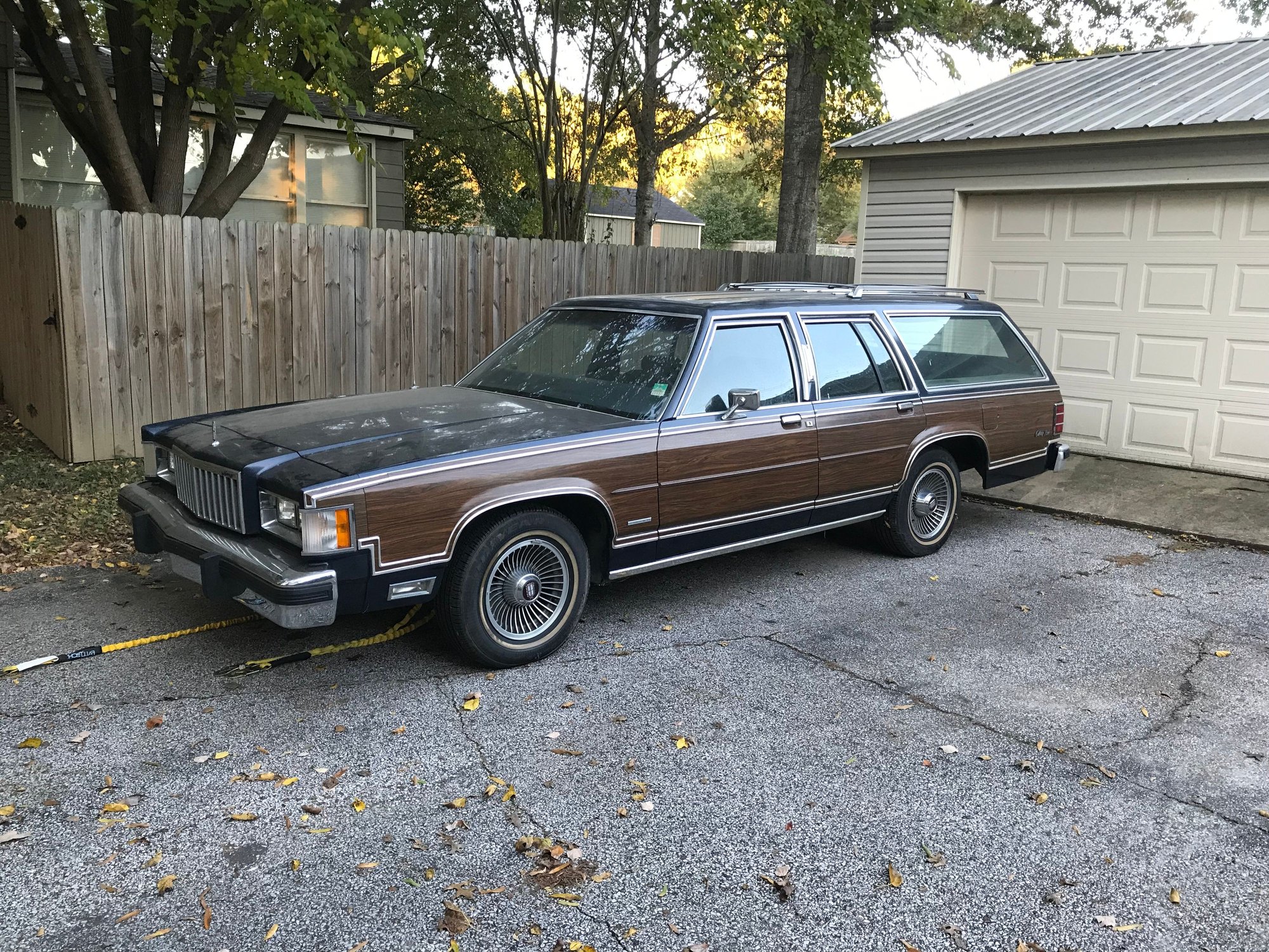

I drained and blew out all the lines as much as I could. Once the remaining bad gas was out, it ran smoothly. Had some oil on the exhaust that had to burn off. Drove ok to the end of the driveway and back but the engine light came on and I shut the car off. Coolant was a little low but oil level was fine. But now it won’t start. Argh. I was hoping to get it over to the detailer this week.
other than that it’s in excellent condition. 34k miles.

Once I replaced the fuel items this morning, I managed to get it running pretty smoothly. Let it idle for a while then drove it up and down the driveway a few times. The engine light came on so I shut it off. It was low on coolant but wasn’t overheating and it’s got plenty of oil. But when I tried to start it again it cranked over but didn’t start. No sputtering or trying to start, just cranking. I’m pretty sure it’s ignition since I tried spraying some starting fluid and it made no difference. The first place to start is checking for spark unless there is a common problem to check that causes something like this.
