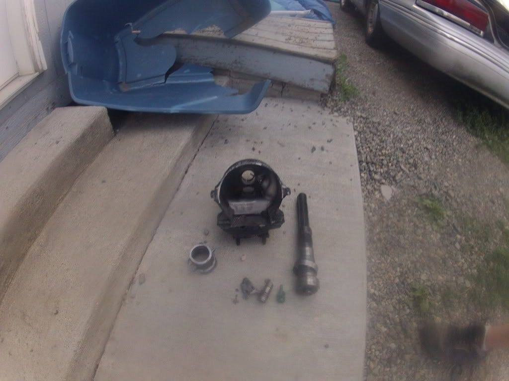

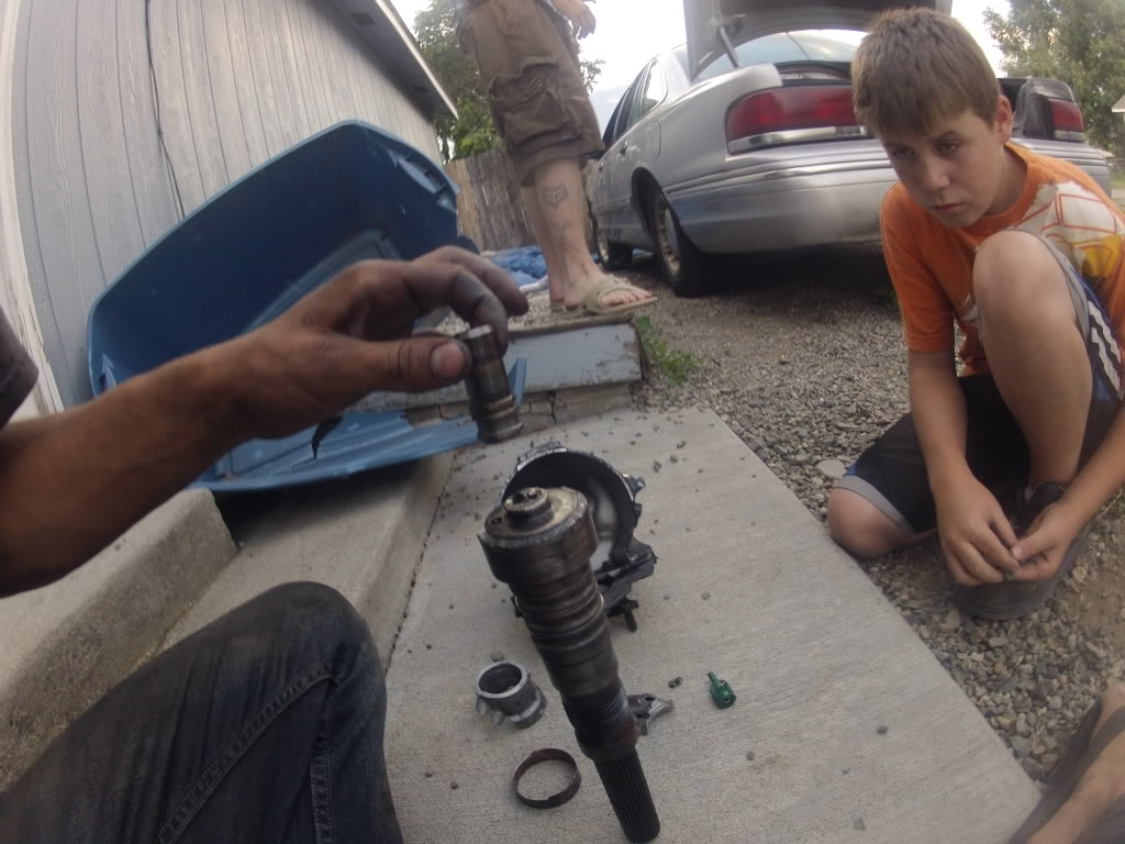

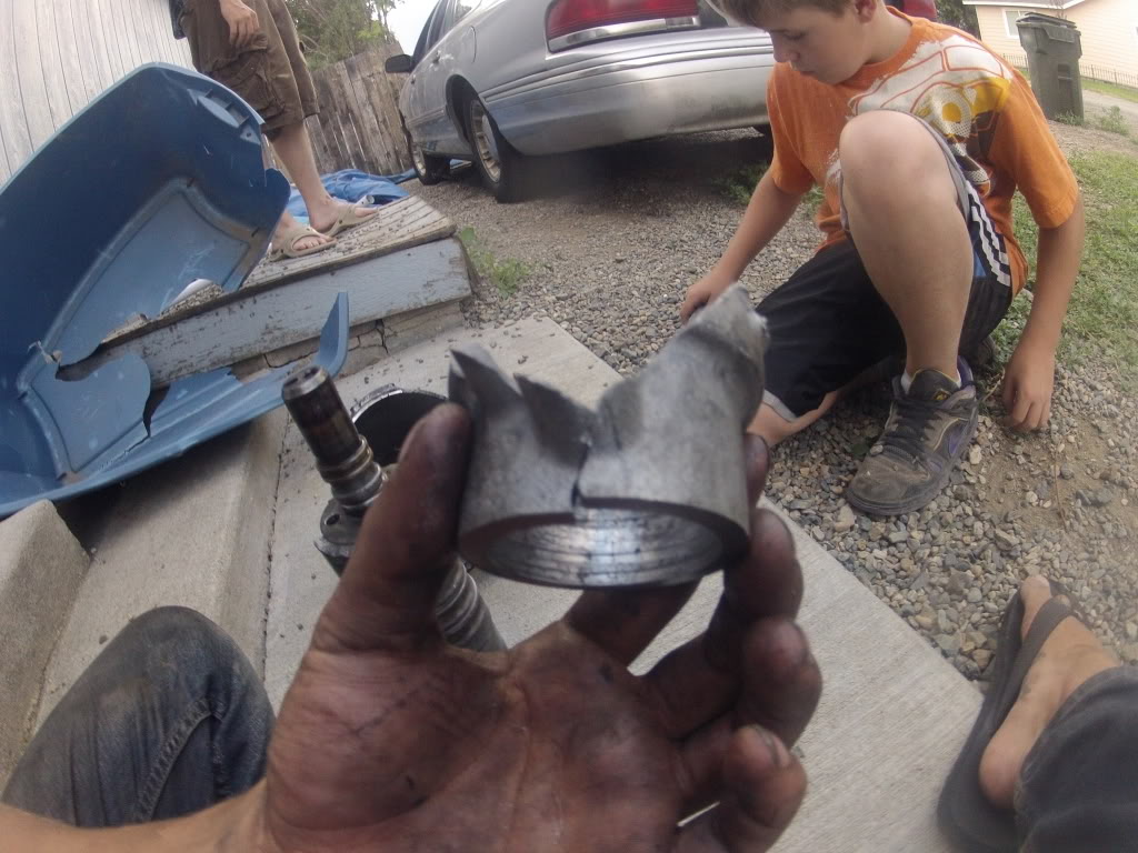

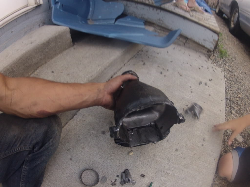

i purchased this automatic 95 crown vic for $200 and drove it home and thats as far as she made it after inspecting the original owners tranny gasket leak that he supposedly fixed this is what i have found.... he didnt tighten anything down properly.....the rear shaft is broke, part of the tranny it self has broken off and there was quite a bit of shreaded metal in there... so my question is how hard is it going to be to put a new tranny in the car ? and what other years/models can i use a tranny out of ?

I guess there's a first time for everything and that's the first time I ever saw anything like that. You may be able to get a good answer from a Ford Parts dept as to what will work, not fit, and what won't.

ok so i found another tranny at a salvage yard for $180 came out of a 95 and they say if it dont work and or fit they will let me trade it in for another. so looks like i know what my next weekend will be like lol ive never seen anything like this either i was in total when i pulled it all apart
Old Jul 17, 2012 | 02:29 PM
Posts: 16,668
From the pix , looks like you didn't have to pull too hard !!
