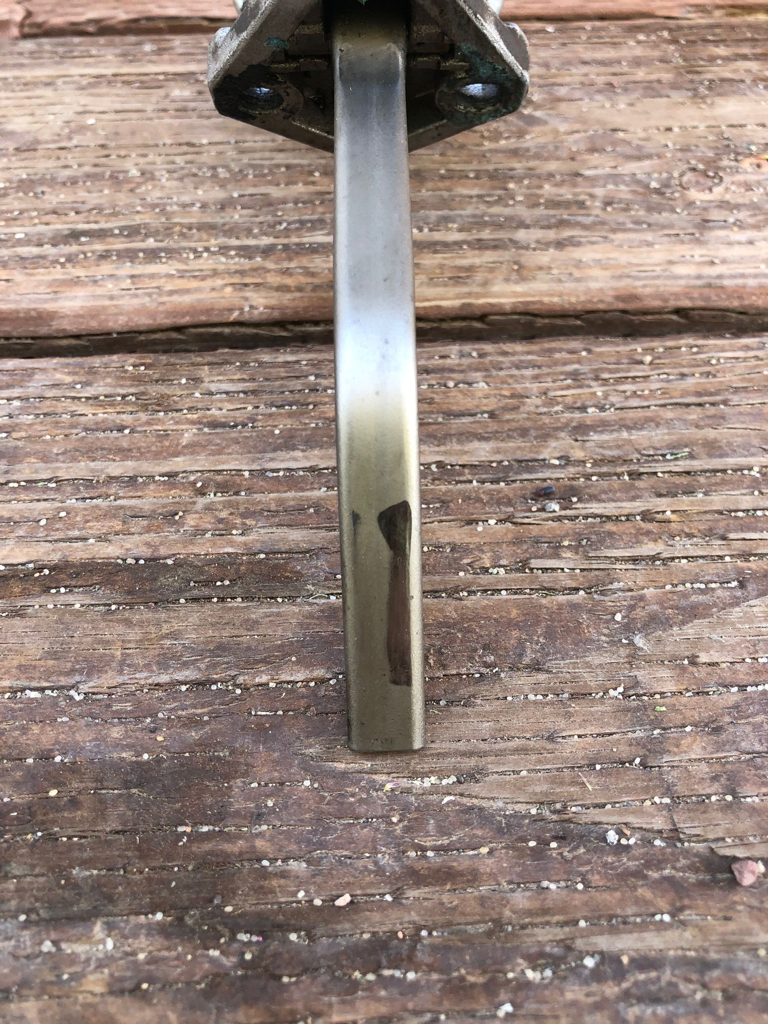

Problem solved, engine now runs fine. I installed a new mechanical fuel pump and rubber hose that connected the steel line from the tank to the intake of the fuel pump. The old rubber hose had a soft area where it bent connecting to the pump. The old mechanical pump didn't appear too worn, but noticed uneven wear on the pump arm connecting to the engine eccentric cam (see photo), only about 1/2 of the side of pump arm appeared to make contact with the cam. Uncertain whether this is a sign of cam wear or an uneven installation of the old pump, suspect the latter.
Uneven wear of pump arm where it contacted the cam.
