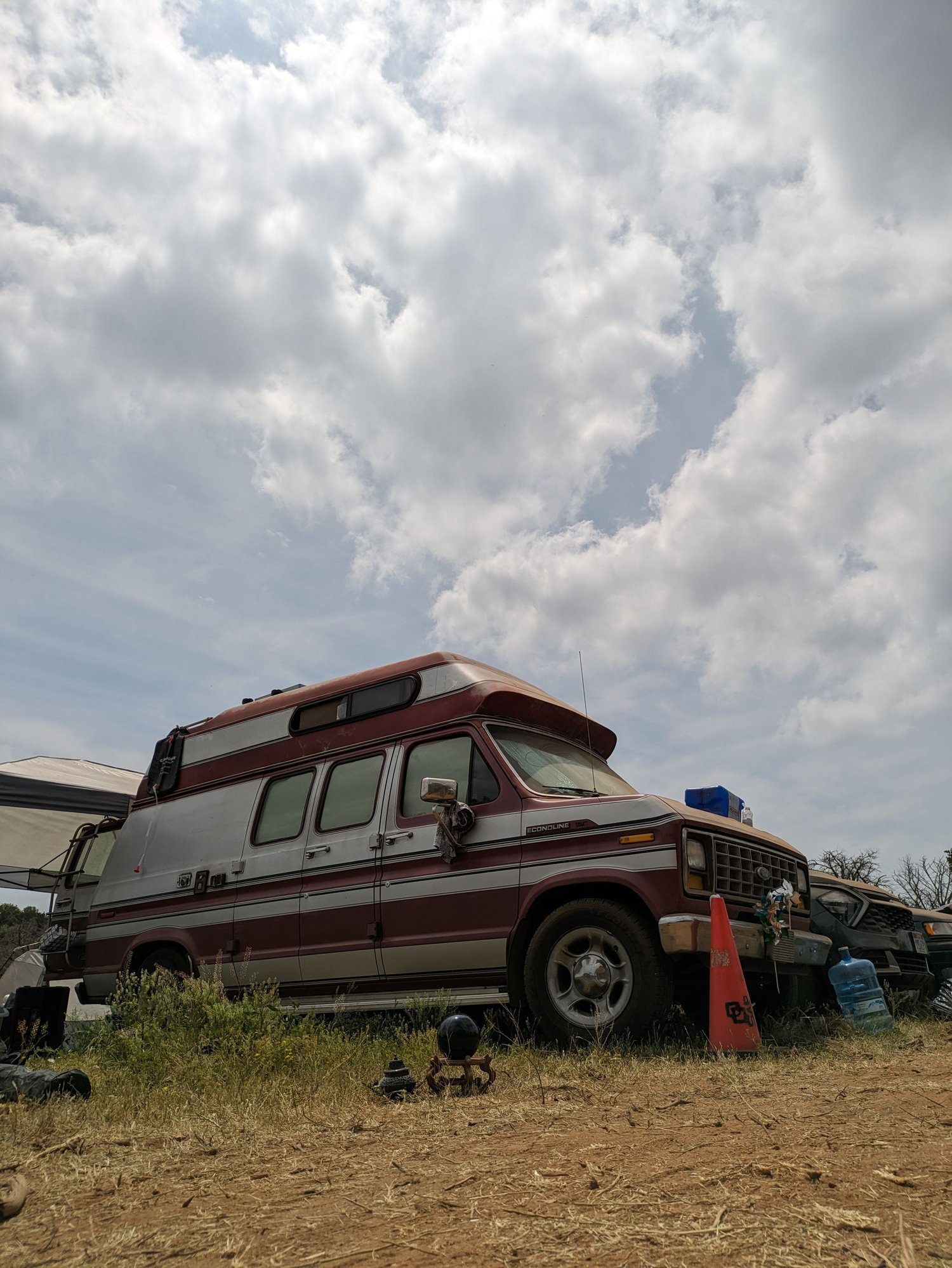

Hello all, I have a 1988 Ford e150 travel wagon.
Recently my driveshaft popped out and I was not able to find it.
Vin:1FDEE14NXJHB16212
From what I know I have a 5.0L with a 14 bolt transmission pan.
I measured from the back joint up to the trans yoke and have 72"
My mechanic and I are struggling to identify the proper series of lengths and linkages to get my van repaired.
​​​​​​Any advice is welcome.
