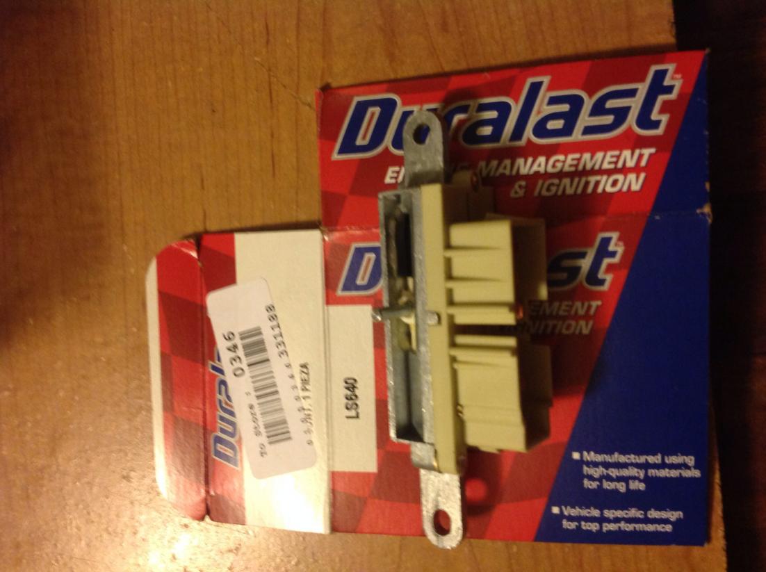

Here is the part I bought, and am installing. Ignition switch, not the cylander.

Issue resolved! Thanks Hanky, I was seriously doubting your advise ONlY after tearing apart the multifunction switch. It was so corroded and I doubted the cleaning I gave it. apparently I also have more than 2 wiper speeds!
